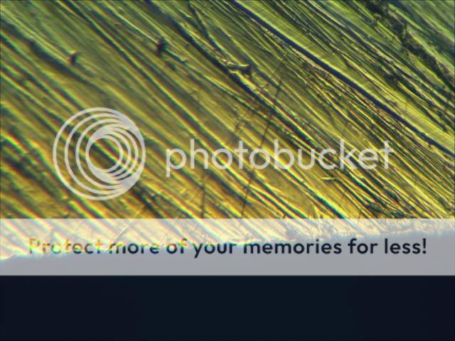

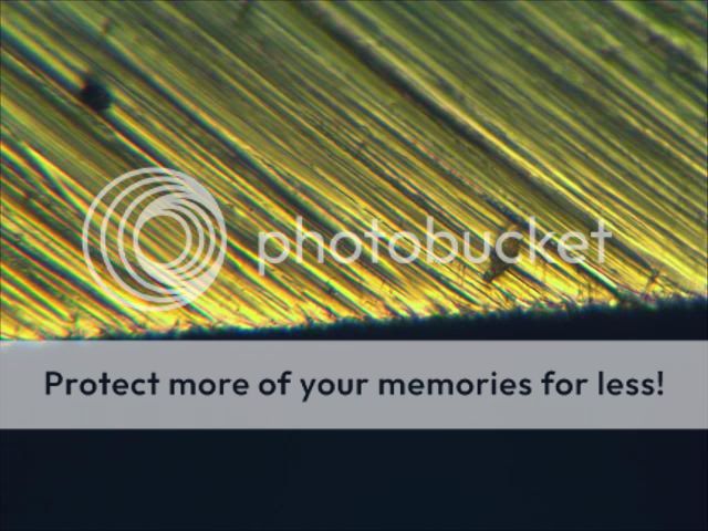

Was busy using the new microscope again, and finally took some more shots of different stropping compounds and how they might affect an edge. For a while now I've been jumping down a few grits on the strop to "refresh" an edge - nothing unheard of around here, but not many take it down as low as I do so I thought I'd throw this out there. Have a series of pics at 640x, the first is off of the fine side of a cheap AlumOx bench stone and stropped w/ Flexcut Gold, the second pic is after hitting the edge with 220Sic lapping compound, the third is after some black emery from Sears (my personal favorite for EDU), and finally back to the Flexcut to see how it would react. Used approx 20 passes/side for each change. The edge initially could just tree-top some leghair, though not consistently, and could easily crosscut newsprint. After hitting it with the 220SiC it could still shave some arm hair and cut paper with the grain but needed some draw to crosscut. Following the black emery it could crosscut newsprint with a push cut, shave armhair easily, and still had a lot of "tooth". After the second time around on the Flexcut it could no longer treetop leghair, but could dryshave facial stubble, crosscut newspaper etc. A bit more time with the black emery before going on to the Gold might have restored it entirely - you can see where its not quite as smooth or uniform as the first picture. Anyway, I'm adding this because I find that a relatively coarse strop comes in very handy for preventing trips back to a stone especially on "overstropped" edges- have even used it to sharpen softer kitchen knives that had been tossed about in a drawer and were quite dull. I used to use it only on my coarse-edged working knives to remove burrs and improve the edge off the stone, but its come into its own for a number of uses. On harder metals there's only so much you can do with a loose particle on a strop, but it never hurts to experiment. For keeping frequently used knives in good shape I can't recommend this strongly enough for saving time and steel.
