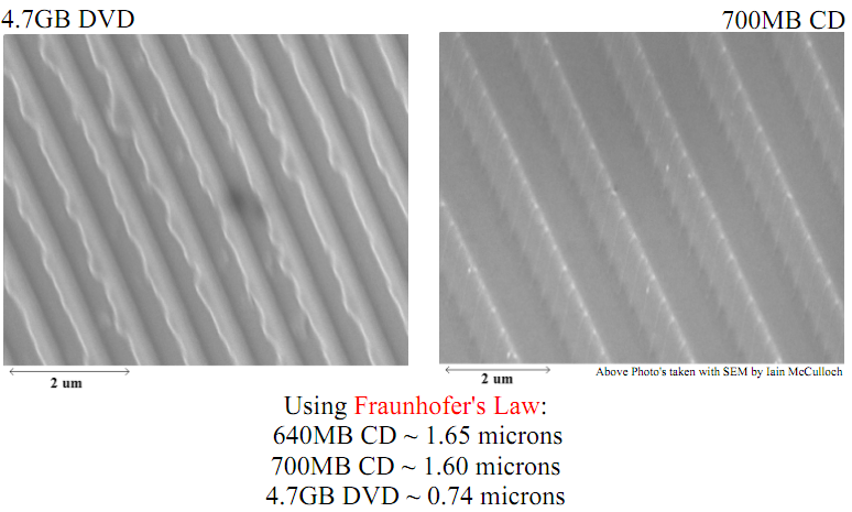

But, how about using a DVD disc or a CD disc as a calibration target?
4.7GB DVD has a track-pitch of 0.74 microns.
650MB CD has a track-pitch of 1.6 microns
For studying knife-edges, these should be good enough.
Image From:
http://mse.mcmaster.ca/undergraduate/courses/2H04/Tutorial1rev.pdf
Additional Reference:
http://en.wikipedia.org/wiki/Dvd#Technology
If you're able to try this out, then let us know if it works.
Hopefully it does, since it's a zillion times cheaper than a true stage-micrometer.

No go, my microscope can barely pick out the lines, and not clearly enough to use for a scale - the lighting washes it out or is not enough to see the lines at all. I'll keep at it till a suitable substitute finds me.
@HeavyHanded:
Oh darn, that's too bad.
Speculation:
Maybe the spacing is too close to the wavelength of visible light, which is 0.4 microns to 0.7 microns. For the DVD, the tracks are 0.74 microns, so may be too close. For the CD, the track pitch is 1.6 microns, so maybe more hope here. But the CD tracks are ridges with valleys between them, so the width is half, at around 0.8 microns which may be too close to visible light? On the other hand, some scale-micrometers have markings every 2 microns, which isn't so far away from the 1.6 microns. So, I don't know...
Thanks for trying!! :)

The problem with using the CD is that the above pictures were taken with a SEM.
You might be able to see them with a scope that shines the light through the lens but any scope that uses surrounding light runs into major issues with depth and shadows.
@knifenut1013:
I think you're right... I was hoping that the CD tracks would be visible, just like scratches in a blade edge. Since a lot of scratches are easily visible in micrographs (like from HeavyHanded, or various USB microscope picts (such as from Clay Allison)), I thought CD tracks would be the same. Oh well.... :(
I'm going experiment with a CD-R later (blank and/or with recorded data), but my set-up probably does not have enough magnification to see them.
Sincerely,
Under magnification with a metallurgical microscope (directs light into the objective, no external light source needed. In fact when viewing opaque objects, no external light source can be directed onto the object - the lens is too close for light to get in at anything above 400x). i could just make out the lines in a CD as faint ghostlike wriggles - far too indistinct to use for calibrating, as they weren't even visible to the camera, though with the proper filters on my light source I'm sure its possible. My math-derived scale is probably pretty close though. I took a look at some unfused toner particles and at 5-7 micron range they showed up as between two and four mm on my screen at 640x.

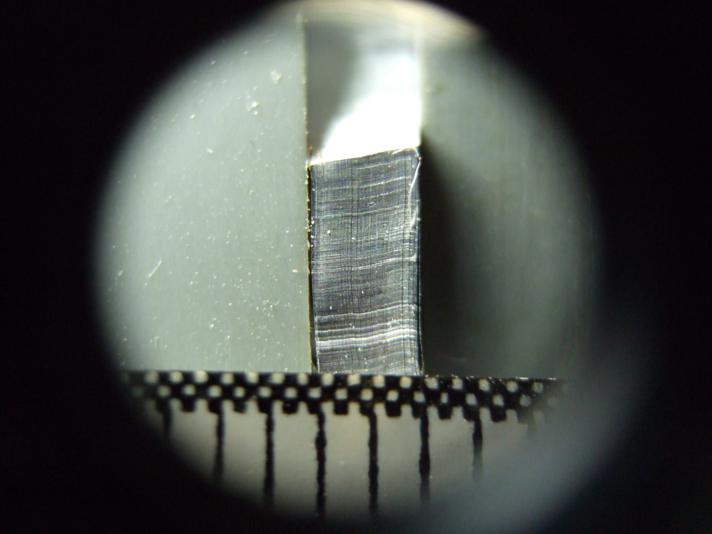

Ken Schwartz (Ken123 at knifeforums.com) pointed me to a link that shows you can buy a stage-micrometer for around $20. (You can buy the the stage-micrometer separately, without the magnifier.)
http://www.tedpella.com/magnify_html/magnifier.htm
It looks like they go down to 100 microns, which might not be fine enough unfortunately. But if your field-of-view is wider than 0.1mm, this should be good enough and pretty cheap! :D
"Standard Metric Scale ... 0 to ±10mm"
Sincerely,
--Lagrangian

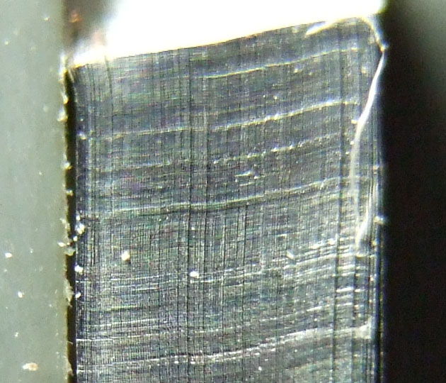

P.S. If you're a little crazy, you can also use household aluminum foil. The foil is about 16 microns wide, so that should be fine enough for 1600x magnification.
http://www.bladeforums.com/forums/s...t-Adding-a-Length-Scale?p=9992368#post9992368
128 layers of household aluminum foil. Fuji F30 camera with 20x loupe.
The ruler markers are in millimeters. The checkerboard squares are 0.25mm wide.
Image has been resized to 25% of original.
Close-up of the above:
"What grit sharpens the mind?"--Zen Sharpening Koan
