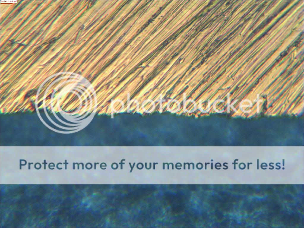

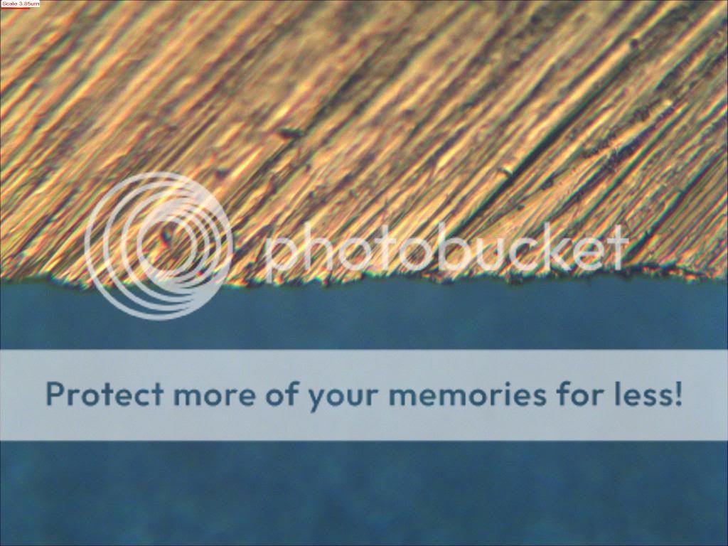

I would say three - four pounds at the outside. Press too hard and there's the possibility you fragment the edge. If you're using the paper over the coarse side of a stone (or Washboard!), you'll amplify the burnishing effect considerably - make sure there's no loose grit on the stone surface. 20 passes should do, maybe as high as 40 before you've gotten 90% of what the method has to offer. A few passes at closer to a half or quarter pound with spine elevated will burnish right at the edge. Since true abrasive content is so low, is almost all burnishing, so as long as you don't damage the edge, it won't round either.
Before:
After:
Same stretch of edge, bottom pic is shifted approx 6 micron to the left. This is 600 or 800 grit. Edge was washed with alcohol and wiped clean prior to first pic.
Not only cleans up the edge in terms of burrs, but refines a bit by burnishing. I cannot prove it, but edge retention seems to go up somewhat as well - at the least it isn't negatively effected.
Maybe so. But for me to realize a improvement in the edge it take me several hundred strokes on the paper. Like 4-500. That's when I start to see a difference in the bevel and in cutting. I just don't think there is enough abrasive particles in paper for it to work in short order. The steel I worked it was 425M. DM

Well, thank you for that information ... I see a difference between the pictures (haha)
