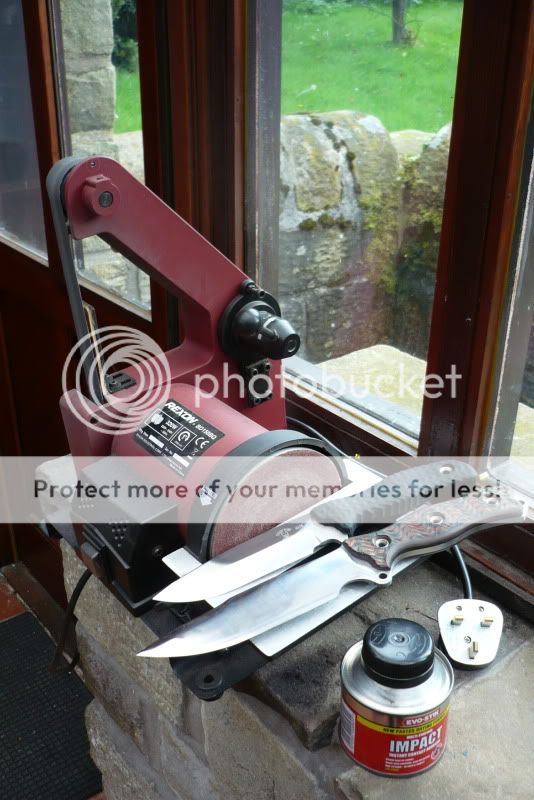

If you want to stay on top of sharpening your Camp Blood what I suggest is looking at the knife in the pic below you will see the polished area of the edge that has been created by using a belt sander to sharpen the blade.
Get a sharpie marker pen or any other type of marker and colour this polished area "black" with ink ...
Then go out and invest in a cheap 1 x 30 belt sander such as I have which is pictured below ... they are cheap and cost about 60 Euro's from DIY shops which are bound to be on the large shopping industrial estates in Germany ... search the internet to find one in your area ...

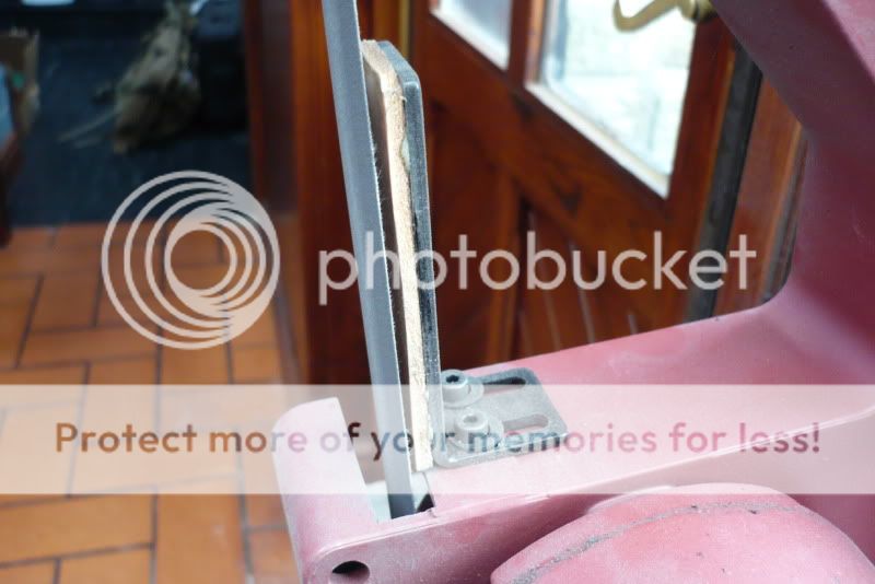

Then get some good leather hide and cut a few sections out which can be glued onto the platten behind the belt as seen below ...

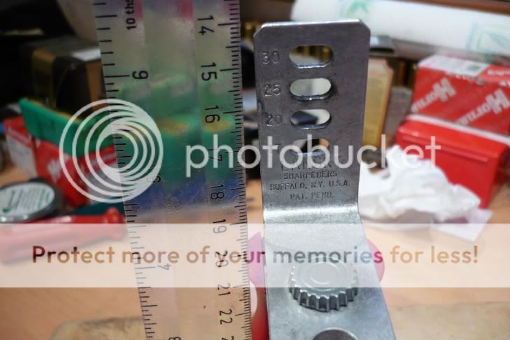

Then look in the shop for some belts to go with the sander ... if they have one course belt and one fine belt in their range they will do ... even if they are designed for "wood" and not metal they will work to learn with ... but by checking on the internet try and find a good supplier of belts for working with steel ... 240 grit is ideal ... then buy some blue tack or plastercine and some string and a simple bamboo stick or get one from the garden and buy an angle protractor like that which we used at school ... they are half moon shaped with the angle lines showing ...
Mount the stick using the blue tack on the top of the sander and anchor the string using the blue tack on the frame near the platten ... use the protractor to judge the angle of the string to the belt ... tie off the string on the stick so that it gives you an angle of 20 degrees to the belt ... it then acts as a reference point as to what angle you have to hold the blade to the belt to get a consistant edge angle ...make sure the string crosses the belt at the point on the platten where you want the edge to "contact" so the angle is truly 20 dgrees ... then use some cheap knives to practise on and starting near the handle draw the knife along the belt to the tip. As you get to the belly of the blade lift the knife towards you to increase the angle steepness so you compensate for the belly curve and when you come to the tip pull away from the belt so you don't round off the tip ... rounding off the tip makes it look like a pizza cutter ... you want a sharp point not a rounded edge ... the steeper the angle you hold the knife to the point the better ... do a few cheap knives using the marker pen to show where the metal is being removed ... and practise doing one side of the blade and then the other ... this means using your left hand as well as your right ... but practise will give you "the knack" for doing this.

This sort of skill is a great benefit ... in time the leather backing will develop a curve caused by the erosion of the back of the belt ... this enables the covex profile to be achieved easier but remember to change the leather if the curve becomes too much ... leather "gives" when pressing the knife to the belt and a flat bit of leather or a slightly curved bit works best ... the leather stops the knife from "chattering" against the platten. If you have a large knife you can use the belt above the platten to start the process but if there is not sufficient tension in the belt you need to finish the edges using the leather backed platten. This gives you a good consistent steep angle for a really great edge profile. It basically enables the string to work properly as a guide. After a while you won't need the string ... the angles and muscle memory start to work for you as to the right way to hold the knife to the belt.
