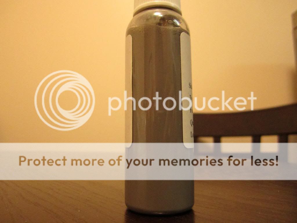

My post has nothing to do with the name on the bottle. The fact of the matter is that neither Poly or Mono slurrys or emulsions make a bright white compound. Aluminium Oxide on the other hand does.
For example , here we have a Poly Slurry , with a known carat weight and particle size distribution , this bottle is pure diamond , with no other abrasives added in.
Notice the color? Dark grey / Almost Black.
