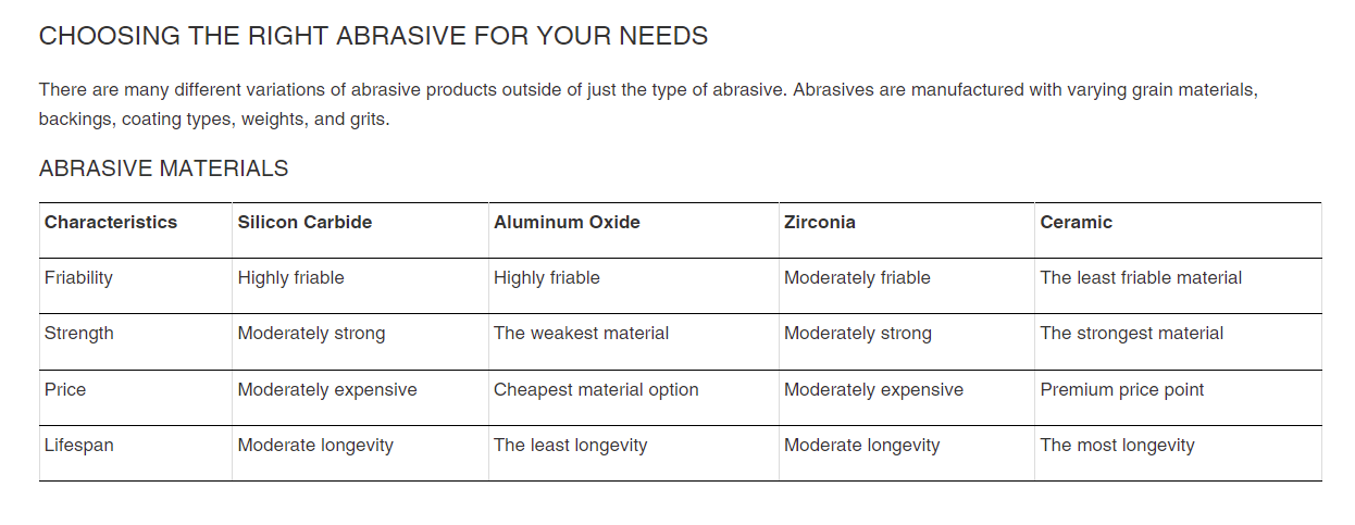

I just checked out the stuff on the red label abrasives site talking about different abrasives, and I didn't see anything said on ceramics that clashed with what the all about abrasives article said. Also I didn't see anywhere mention that ceramic abrasive is just al2o3 binded with ceramic, on either site.Also are you positive on the ceramic being al2o3 binded with ceramic? I ask a lot of questions, sorry mate lol.

Oh ya sorry man I didn't mean that question for you it was the guy that mentioned it. I probably should re-read em but im. 99.99999% sure its pure ceramic? May be wrong and I'd like to know lol..Also I didn't see anywhere mention that ceramic abrasive is just al2o3 binded with ceramic, on either site.
I'm honestly kind of thinking he was mixing the structured ceramic abrasive into the equation. Like the vsm structured ceramic abrasives someone mentioned, are ceramic aluminum oxide. That are basically grain that are sintered (I'm guessing) or bonded together to form a larger abrasive grain that fracture off in a more controlled way. 3m also had the cubitron structured ceramic abrasive that I believe is sort of the same deal.Oh ya sorry man I didn't mean that question for you it was the guy that mentioned it. I probably should re-read em but im. 99.99999% sure its pure ceramic? May be wrong and I'd like to know lol..
What makes me so certain? Is the wording and the way it's described.
It says varying grain materials, and then proceeds to list each one separately.... Obviously that. Is not a factual answer? But it seems like it at least?![]()
Oh of course ceramic al2o3 is different. How? It's bonded with ceramic! Don't ask me how exactly such as if it's actual mixed al2o3 with ceramic and then fired (could that be done? I think that al2o3 has a really high melting point but I'd have to check) and is part of the abrasive or if it's some kind of ceramic resin but I am likewise pretty sure that those would not be in use now and that ceramic like r980 is just pure ceramic that has better frangibility? Than things in the past. The reason I said the date thing is because from that time until now while technology hasn't really changed so much it's improved and more affordable for different purposes. Abrasives however.. how do I make anything without abrasives?I'm honestly kind of thinking he was mixing the structured ceramic abrasive into the equation. Like the vsm structured ceramic abrasives someone mentioned, are ceramic aluminum oxide. That are basically grain that are sintered (I'm guessing) or bonded together to form a larger abrasive grain that fracture off in a more controlled way. 3m also had the cubitron structured ceramic abrasive that I believe is sort of the same deal.
However from the reading I've been doing, it looks more and more like ceramic aluminum oxide is different from just aluminum oxide. Much like the different grades they listed in the article I listed. I'm just not sure exactly in what way it's different.
