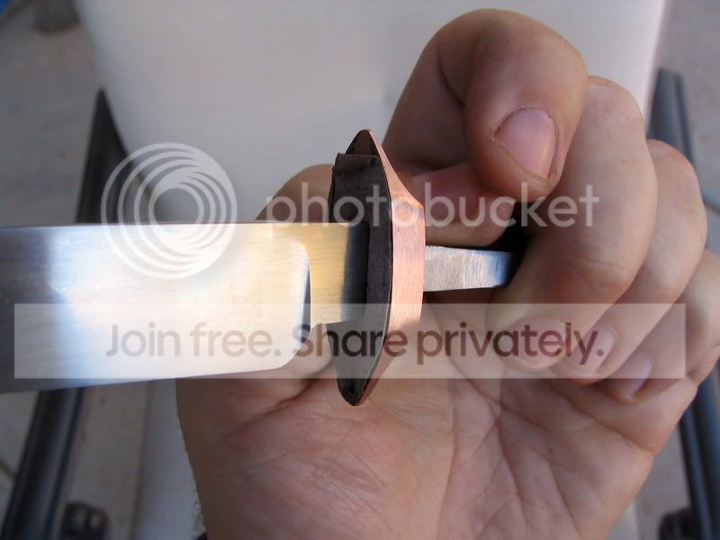

I'm kind of stuck here, and could use input on both my design and execution. I will try to keep this convoluted story as concise as possible...
I am working on completing my first forged blade (which is also my first stick tang and guard.) I forged this knife to be a hunter, but once I cleaned up all the scale, etc. on the grinder I ended up losing part of the blade to the dust gods. At first I was ready to toss it in the scrap bucket, but after looking at it for a while, I decided it looked like a 'mini' fighter or bowie, so that's what I decided I would try to make out of it. As usual, I'm trying to do something beyond my skill level.
I've been tinkering with the guard for quite a while now, and the following issues are stalling me:
-proper shaping of a guard
-shaping a guard in the proper fighter or bowie style
-accomplishing the above, while successfully achieving a balance between it looking 'right' with the scale of the 'mini' blade, but also having a handle that will fit the hand when all is said and done. At the moment, I'm not sure I'm successfully accomplishing either, specifically with regard to the width and height of the guard.
-how much shaping/finishing to do before installing the wood (ie, have I done too much, not enough, or about right?)
I think that pretty much covers things. I would like to receive input on all of the above issues (or anything else you may see that I haven't thought of. If it helps, I can also remove the tape from the front and take another pic. Thanks in advance for the help!
PS cutting edge is about 4 3/8" long x 3/4" at it's widest point if that helps. I've been working on, and staring at, this one long enough that I could use some fresh eyes and perspective.
Thanks again,
Paul

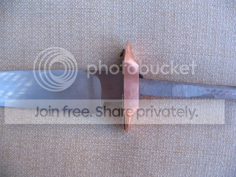

I think that looks pretty damn good PJ . I myself ( this is just me ) would put a sanding drum in the drill press and put a little more curve into the upper and lower portion of the guard if that makes sense
I would suggest making the shoulders of the guard even with the Ricasso shoulders. (see pic)

Thank you Stephan. I could go a little further but not all the way there due to the guard slot width. Aside from that, I wasn't sure if that would leave enough thickness in the handle at that point and/or if some should be left to remove and blend after assembly with the wood block. Would you recommend doing that now as opposed to after glue-up?

Thanks, Jack. I first put the curve in with the belt and a dremel, than I rounded/radiused everything on the backside (if that makes sense.) Is your advice based upon it being too thick, or you would prefer it flatter without the rounding, or is it a combination of both???
To my (untrained) eyes it looks as if the guard should be perpendicular to the long, flat, straight edge of the blade. The tilt looks kind of funny right now, but I suppose that could change depending on what the handle looks like.

It's just on there loose right now, hasn't been glued yet, although when pressed up tight it does sit ever so slightly with the top forward of the bottom. I don't think it looks too bad like this, but I'm thinking I might be able to make it square when I glue it.
i generally do my shaping after glue up, unless it's a stag piece like :
Then I get it close by eye, the scribe the joint and do ALL shaping and finishing before glueup
As far as having a forward slant, it's not uncommon for the spine side to be slightly forward of the edge side (like yours appears to be) but not the other way around, if that makes sense
Get everything square (or however you want it) before you ever mix up the epoxy. When things fit well, you can assemble the knife with just a pin or threaded tang nut and it would be fine. (I use epoxy as well as pins, but it can be done, look up some take-down models for inspiration)
Next time, cut the guard slot so the spine/edge sides of the hole are angled/sloped the same as the shoulders on the tang. It will fit much more solidly and won't interfere with your handle design. As it is, that's going to have a very thick handle in relationship to the blade.

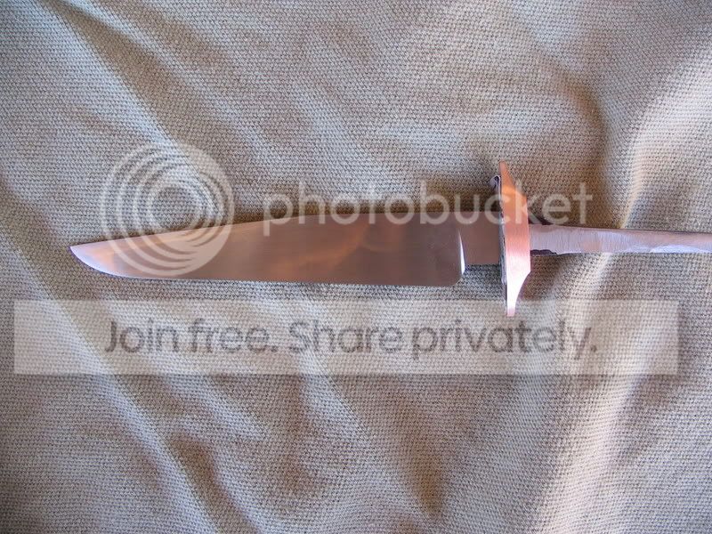

I'd start over and save that guard for a bigger knife, to be honest.

"Start over" were the last words I wanted to hear but I thought that might happen. What do you guys mean specifically by "start over":
-Toss the knife in the trash?
-Start over on another guard with this knife?
-Start over on the guard in a different style?
Also James, I'm not totally sure I follow this part...could you clarify a bit:
"Next time, cut the guard slot so the spine/edge sides of the hole are angled/sloped the same as the shoulders on the tang. It will fit much more solidly and won't interfere with your handle design. As it is, that's going to have a very thick handle in relationship to the blade."
As far as being square, it sits now at a very slight top forward rake which I don't find unappealing, but if it came up more square during glue-up I wasn't going to be disappointed.

The good news is that I'm braced and prepared to start over if needed on the guard. The less than good news is that I'm not 100% sure what to do differently the next time :-) Is the primary problem the height of the guard slot preventing me from bringing the shoulders down as Stephan Fowler drew, thus also allowing a slimmer handle? If not, where else have I gone off the rails?
