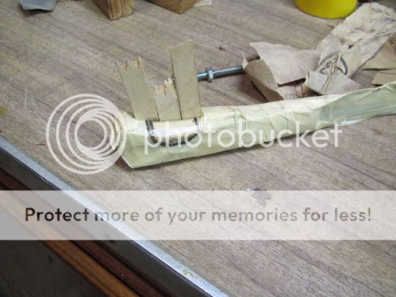

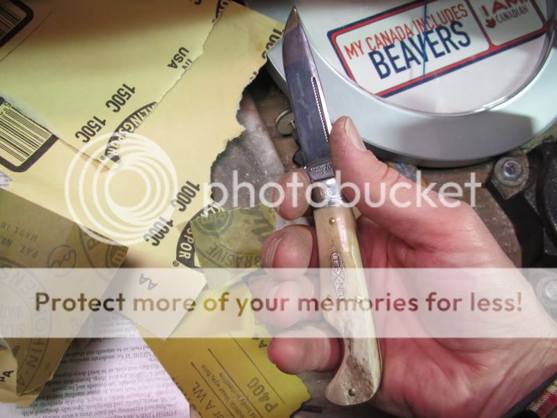

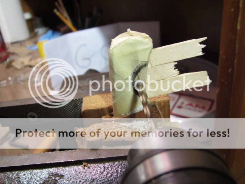

Been getting more and more interested in traditional knives and picked up a GEC #68 in Snakewood a little while ago. I really liked it but the pull was a little soft. When I saw a used GEC scout up for sale with the pull listed at an "8" I thought "cool, this one might be right up my alley". Well... after getting the knife I tried to open it up and son of gun if it wasn't just about impossible for me. I tried everything I could think of (including letting it sit half open trying to weaken the spring for a week) but the fact remained that this knife was pretty much a paper weight for me. After being completely frustrated I was holding it last Saturday thinking, if I could only grab the blade and pinch it open... Suddenly the light bulb went off in my head and I remembered some Easy Open patterns. I decided right then to make it happen!

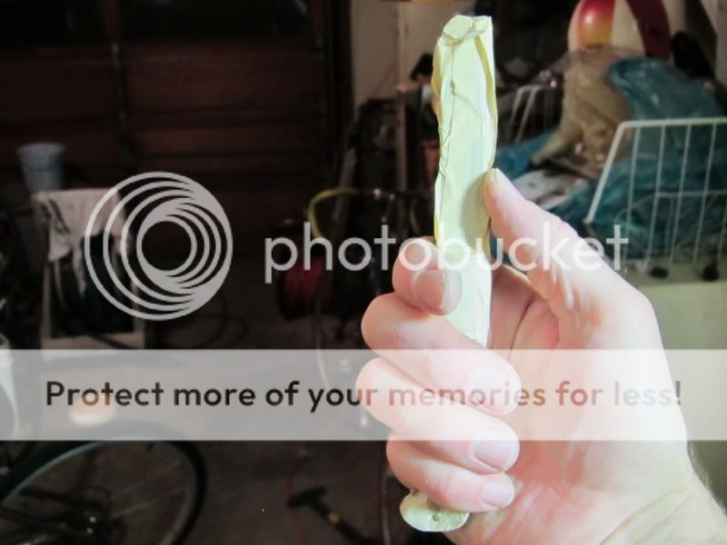

Lets see.... I think my thumb and index finger should go just about here...
Quarter to 10pm... Let's get started....

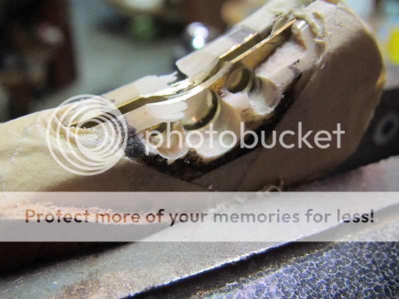

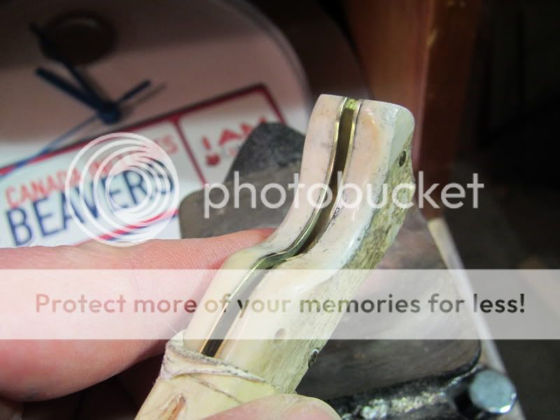

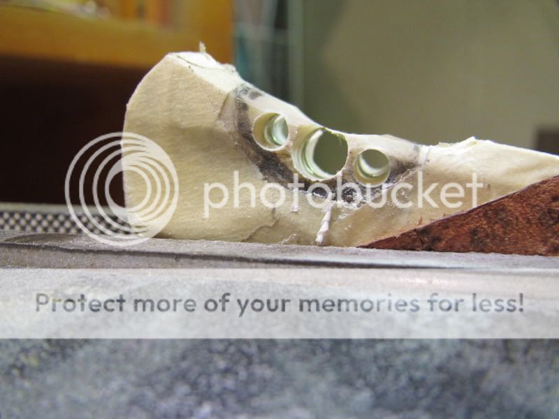

Damn! I drilled a little too fast and the bit was probably too sharp. Cracked the bone on the right side. Looks like my design will be modified :p

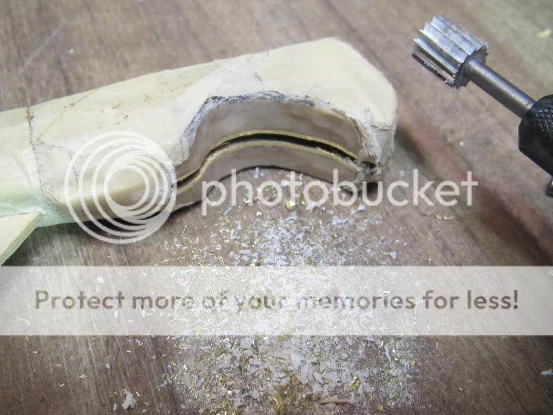

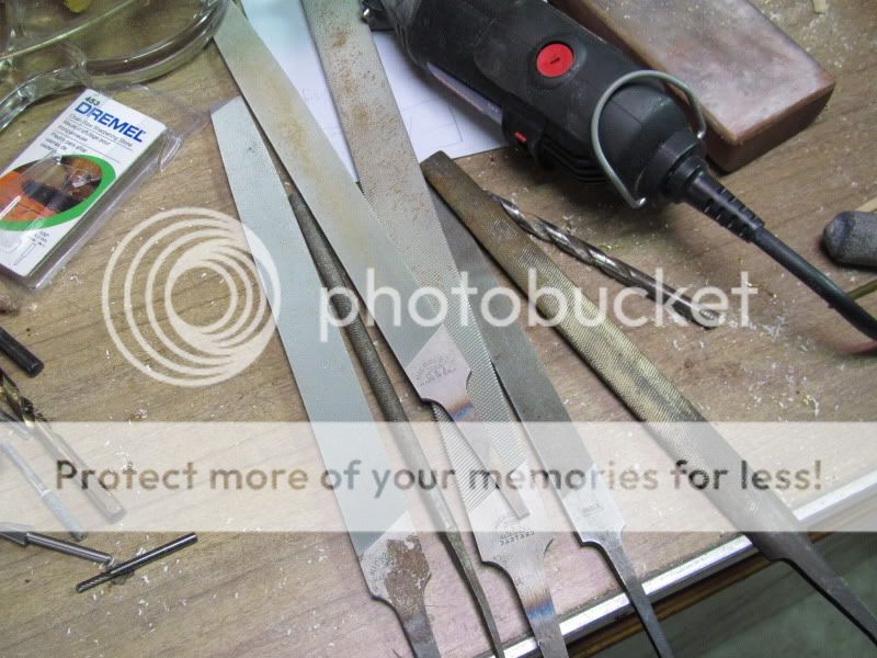

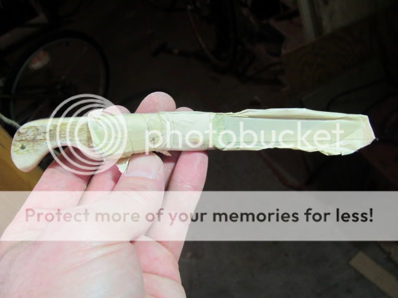

Time to put the dremel to work...
.... and now the hand files and sand paper ...

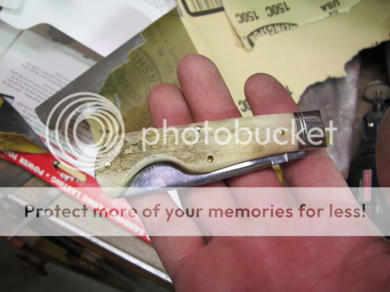

... by George I think this may feel pretty good!

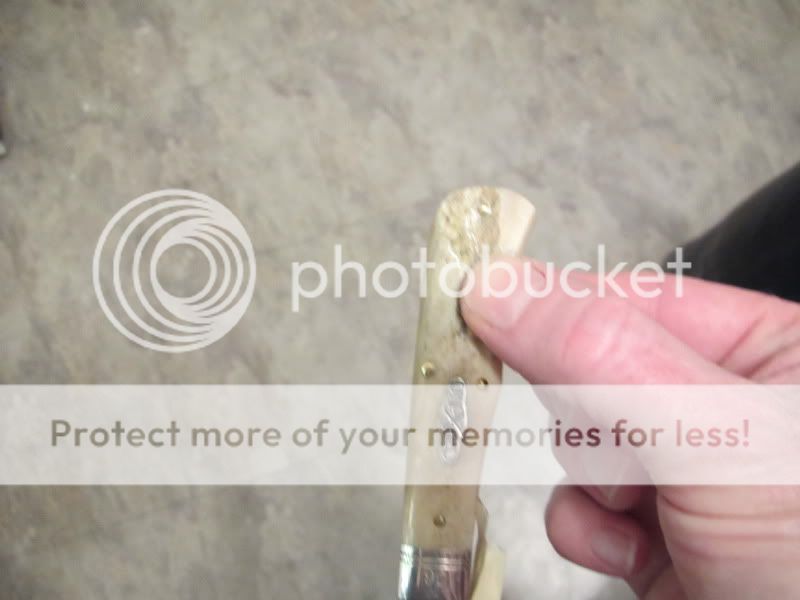

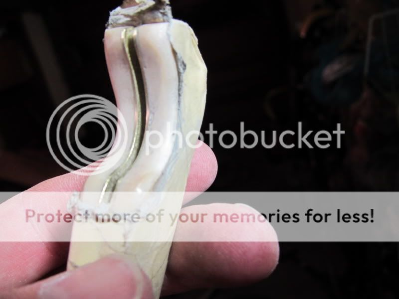

Lets take off the tape and see what we have... (notice the clock say's it took a little over an hour)

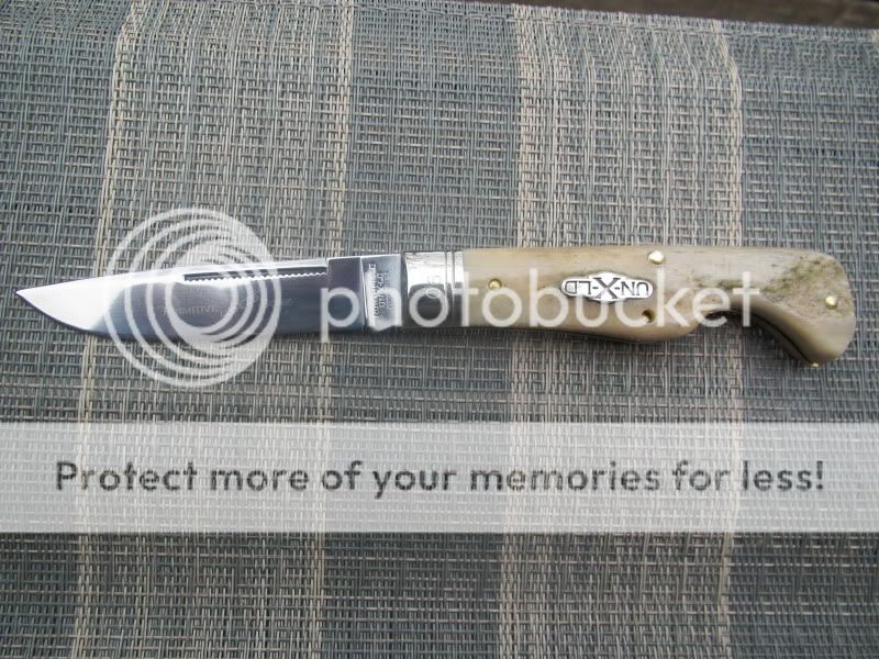

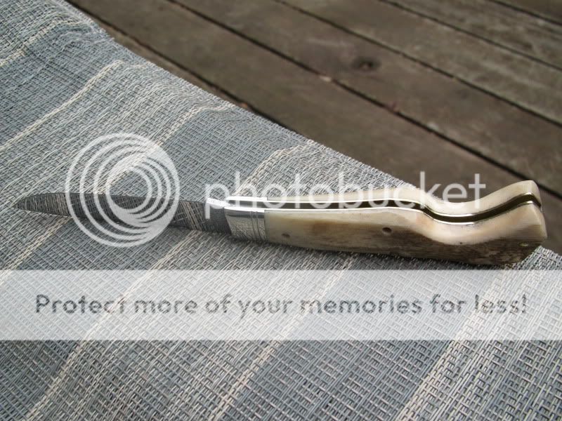

All cleaned up...

I have to admit, I was sure you had screwed that baby up when I saw where the bone had cracked, but damned if you didn't pull it off and make it look great!

Outstanding! :thumbup: I applaud your willingness to take matters into your own hands. Really gutsy on a GEC Primitive Bone. You adapted well to the unexpected chipped bone, too. Basically you just ended up "stretching" the cutout a little closer to the end of the knife than you otherwise planned - is that correct?

Thanks for the good words guys!
Yeah, when I saw that bone crack I thought I was screwed but I just tried to smooth it out as little as possible and got lucky. Doing this with wood scales should be a lot less risky. My only tip would be to take your time :D. I started to use my colbalt drill bits but they were actually too sharp and started to dig in more than I liked which caused the problem. I switched to some beat up HSS bits after that.

Thank's for the reply, and I agree wood scales should be easier to do. I have a fair amount of patience and will take my time. I'm considering using only hand tools - maybe half-round and rattail files, then finish off with sandpaper. I'll probably start off that way, but if it becomes too painstakingly slow I'll use some power tools. :)

awesome mod! gutsy making it an easy open. so the million dollar question is.........can you open it now? :D
That's a great looking and useful mod you accomplished doing that,outstanding work!!Well,how much easier is it to open?

I can open it now with relative ease :). The blade is pretty polished and the spring didn't get any weaker so it's still an effort but I don't look like an idiot trying to open it anymore :D
