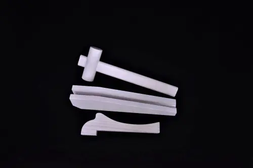

A wood or plastic mallet and drive against the seppa next to the habaki with a wood splint or proper nuki that drives against the seppa, instead of levering and breaking/damaging a tsuba. You can chisel out a groove, to straddle the blade and strike close to the habaki. I see tutes using rubber mallets on rocking tsuba. That's wasting energy. It also cracks tuska. As straight line as you can. Like chasing a bearing race down a shaft with a punch and hammer.
Mr. Natural says "Use the right tool for the job"
wrap/clamp as felt needed
iirc, Keith Larman used to relate simple steps with just a cloth, mallet and nuki.
Per Kieth Larman, in simple terms, strap the nuki on the blade (third hand) "sharp raps", catch kashirae.

Yes, That is the tool I mention previously. Not sure where to get one these days, Namikawa maybe ??Tsuka Removal Tool 1.jpgTsuka Removal Tool 2.jpg
