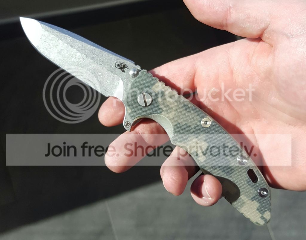

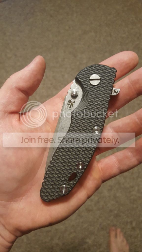

My hunt for a mint XM 18 stonewashed spanto Fatty ended last week, and the knife arrived in perfect shape Tuesday. I looked it over front to back, and from every angle trying to find anything I could percieve as an "imperfection." Not one thing. Lock up was sitting at roughly 35-40%, which I have found to be fairly normal lately with new Hinderers. I thought to myself "would have been nice to see that lock up at about 10-15%" but again, I didnt really consider it a flaw. In fact, the only reason I like the idea of early lock up is because it gives the impression that the lock face will last longer. Its just something fussy that I am happy with when I can get it, but not a deal breaker unless its over 50%. So anyways, all is well except for the digi camo scale that came with it. I quickly ordered a new scale to my liking (green/black) and installed it last night. Heres what happened...

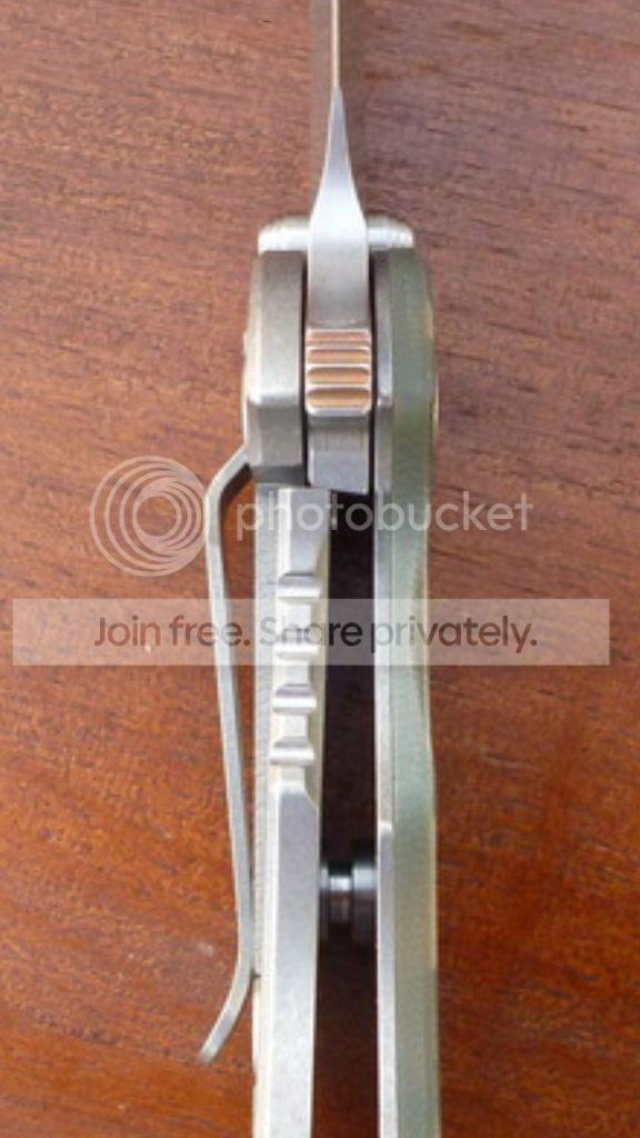

Here's the lock up % before I changed the scale

4. Set new scale
5. Tightened pivot
6. Tightened handle screws
7. Blade was off center. Leaning towards g10 side. Removed all handle screws and tightened pivot with a folded piece of paper wedged on g10 side to adjust blade centering.
8. Tightened bottom scale screw
9. Tightened top scale screw
10. Tightened middle scale screw
11. Removed paper
12. Adjusted pivot until blade was center

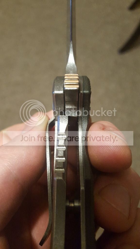

Here's what the lock up looks like now.
I was skeptical at first. I tried applying force to the spine to see if it would fail. It didnt. Then I thought "maybe its just tight? Maybe itll break back into its original lock up position?" So I flipped it... and flipped it... and flipped it. Maybe 200 times since I did this last night. Same lock up. Looks like 15% or so. Im SUPER happy, but i have no idea exactly which step caused this. On a side note, the action is still buttery smooth. The blade easily falls under its own weight and rockets out with either the light switch or push button method. Detent is perfectly medium. Blade is 100% perfectly centered. Anyone have any ideas? I know its been mentioned somewhere here on the forums that this is possible, but there were never any details that I could find. Any help would be appreciated as I would very much like to be able to replicate this on other Hinderers.
