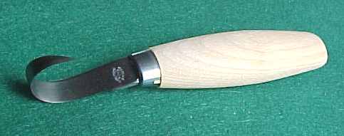

The do make a specific knife for doing the bowl of spoons and such. It looks like this:
Image borrowed from Ragweed Forge.
You can find those under Mora Knives, and then most of the way down the page to "Specialty Carving Tools"

Do those curved bowl carving knives work better when cutting away from you or towards you, if you're right handed? I've not used one, but it seems like it would make more since to have the blade facing you/ cut towards you, no?
I'd like to get one because it stinks trying to carve bowls, etc., with just a plain blade.
I generally scrape them around with the handle starting in a 3 o'clock position, ending in a 6 o'clock position. That way I'm always rounding the bowl instead of just making a groove.
If you want to be able to cut in both directions, Frost does make one that's sharp on both sides. You have to settle for a sqaured end instead of a pointed one though.
