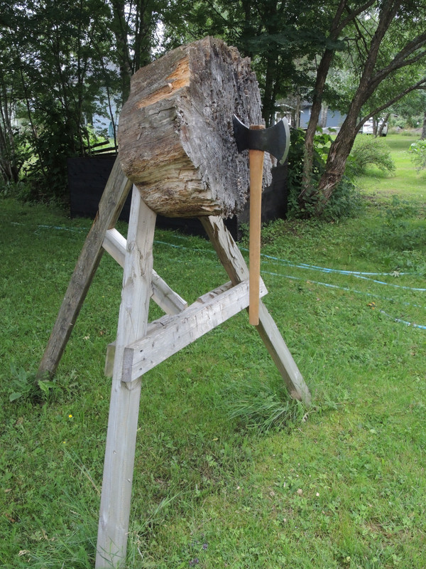

This is what I´ve been using for the last 10+ years:
The actual target is a spruce stump, attached with screws to a frame made of 2"x4"s. The target has been out all year round, replaced once and now the frame needs to be rebuilt due to rot.
Suspending a bucked off bit of tree round like this is a perfect axe target. Just don't use your knives on it, without adding some thick cork board or something similar overtop.

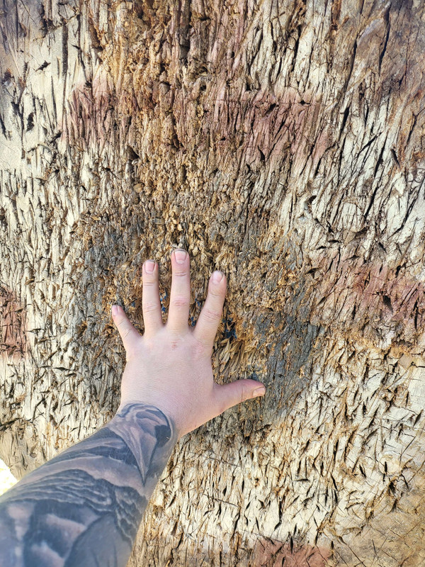

Been using a thick cookie for the past few months for both axes and boker magnum ziel II knives and i havent had a problem. Only thing is the pith is chipped out.
