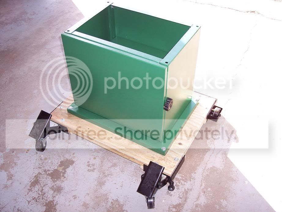

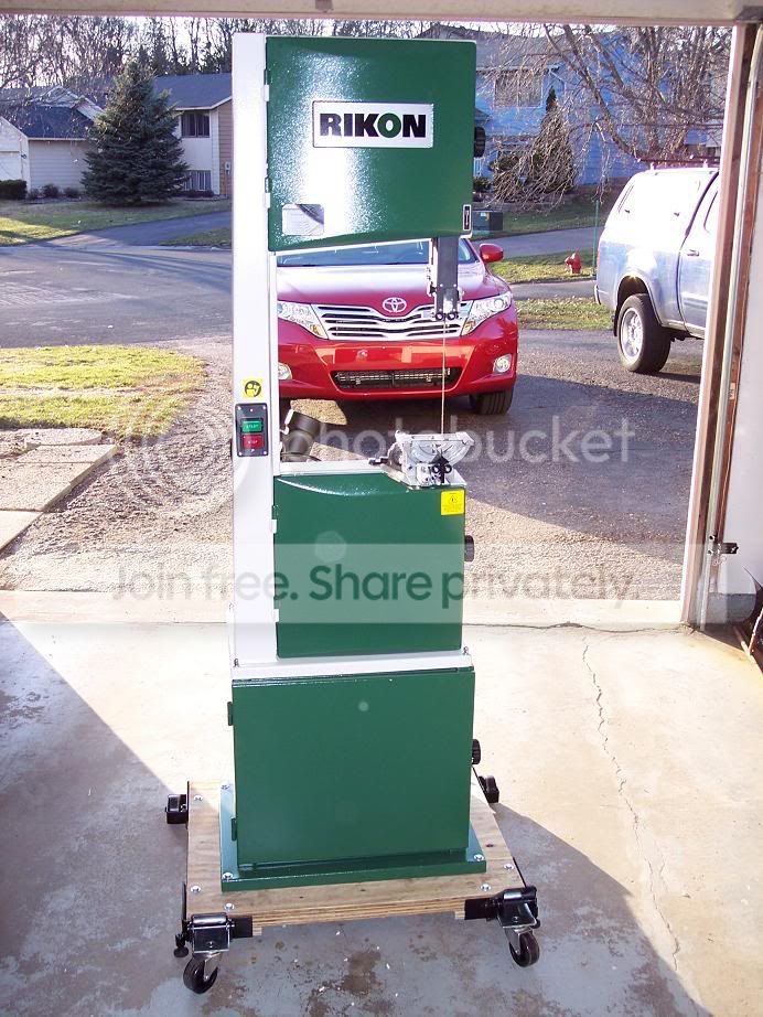

I got the stand and base put together for my new band saw (Rikon 14" Deluxe) and the universal stand from woodcraft. Very solid and heavy. I'm pretty happy with the how smoothly it rolls, and just need to get the upper half of the saw bolted on. The upper half comes pre assembled for the most part, so it shouldn't be too bad.

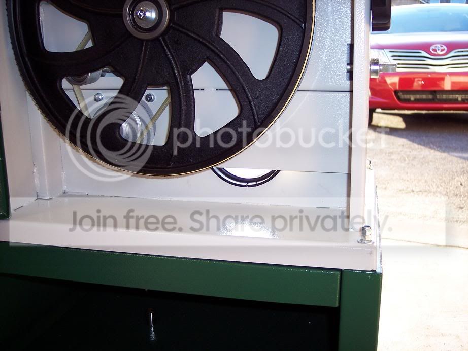

The only thing I really need to do is remove the safety plate in the back that partially blocks the 4" vacuum port. It's tack welded in a few spots and once thats gone it will be much better at removing the sawdust.
Any one have any ideas on removing that plate without having to take off the lower wheel?

Looks like there's a plastic connector that's removable, with it out of the way a jig saw, sawzall or die grinder should be able to remove that section in place.

Why do you want to cut out part of the saw? I will go look at mine to see if there is anything different, but it works fine as is AFAIK. The vacuum port doesn't need to be any larger to allow the sawdust to be sucked in, and the reduction creates higher speed air flow that should draw in the dust better. Think about the vac port on a thickness planer....it is a long thin slot. A big round circle is much less efficient.
I would not alter it.

Well the bottom wheel was not running true, so I had to make some adjustments and I replaced the blade with a nice 1/2" Timberwolf blade (great swedish steel / less tension) and after tinkering for what seems like hours.........She is up and running like a champ.

I would compare the surface area of vacuum port with the suface area of the opening of the downward facing slot. If they are similar, no problem. If the latter much smaller than the former, I would drill enough 7/16" holes in the plate to bring the numbers into line. This presupposes that the port as constructed is ideally matched to the CFM capacity of the vacuum source.
