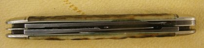

While lubing my pre 1977 no date code Western 742 stockman, I noticed the tangs are more or less flush with the bolsters when the blades are closed.
In your opinion, are these considered sunken joints, or is my assessment wrong?
Thanks in advance.
Like your old Western Stockman there, would suggest that flush tangs like that will likely result in more comfort to the pocket - easier to carry.
Some folders have real sticky-out tangs when shut, and those corners can be a darned nuisance to pocket linings and general wear n tear. That said, if nestled neatly in a pouch, there’s little to worry about.
Aesthetically, and in terms of design, fit n finish - the more flush the better imho. But, really, what the heck………if the whole knife turns you on/is a delight to use, it matters little.
Perhaps most important of all is once open and in use, then there should be no high spots - all nice n flush and comfy to use.
Different folk may not even notice, and at the end of the day - everybody’s right, nobody’s wrong.!

I would call those sunk joints. Better on the pocket but not quite as strong, because there is less engagement between the blade and spring when open.
