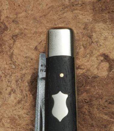

The photo below is a photo I took years ago of Todd Davison's knife #210, it has a semi sunk joint. Todd made ALL his knives with a sunk joint or close to it. Now he makes them ALL with a common joint. Why did he change?
1. - The strength thing.
2. - The look of the knife.

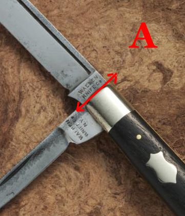

You see on a sunk joint the blade tang does NOT go clear across the bolster like on a common joint knife. (Photo A) Todd wanted his to go clear across for the look of the knife.
And when it doesn't - that is were the strength is compromised. He tried to get both but you can't - believe me he tried.....:rolleyes:
I have seen some knives made on the forums here that were shy going clear across, but still had the blade "Run Up". That is a design flaw in the knife. I will not posted photos of those, you will just have to look for them your selves.
And like it says in the Levine page Charlie posted - Over size bolsters are NOT sunk joint knives.
