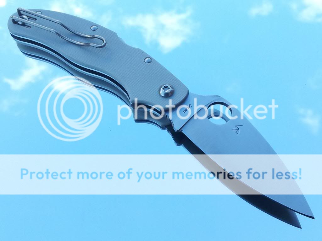

My caly 3.5 in super blue is my office edc. Love the knife. Takes a crazy sharp edge and cuts beautifully. I forced a patina with pickle juice and I think it looks great with the grey handle. I don't carry it around salt water (have a salt for that) but for edc with the patina it is holding up great.
