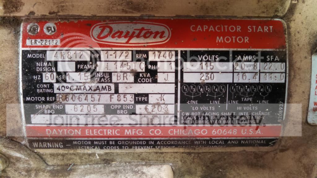

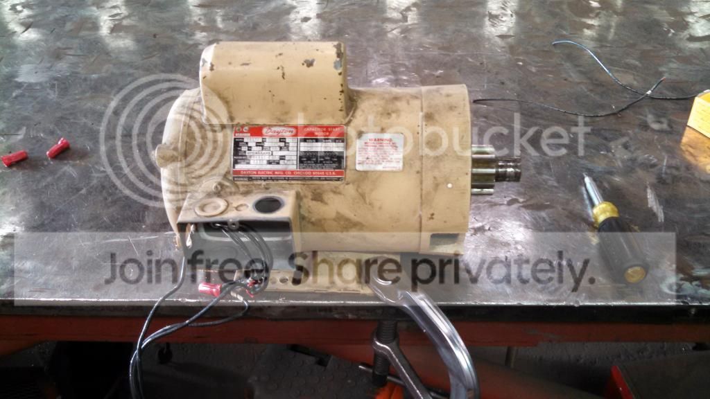

I got this motor for free from work, it had been sitting around for a long time. I had to remove some sort of clutch brake from it, but I wired it up and it works great with 110v. I will soon be using it for my 2x72 build I am in the process of, from plans via bjansen here on the forum. It will start life as 110v but will eventually be wired up for 220v when I can afford some wireing. Only bummer is the shaft is 7/8 so will probably just buy a 5/8 drive wheel, drill it out to 7/8 and cut a new keyway, which won't be a problem to do at work. Any input/advice on this would be awsome, thanks guys. :thumbup:
I know you saw it, but alert, 20 amp draw at 110 volts. Needs its own circuit.

If it was me i would run a new circuit for the motor. Depending if you can do it yourself or not, some 10/2 cable and a single pole 30 amp breaker wouldnt be too expensive. EDIT TO ADD: That is assuming you only had 110 available in that area. If you can run to the main panel or a sub panel with 220 i would certainly be running it on 220.
It actually draws 22 amps at startup, being a capacitor start motor. They aren't the best choice for a grinder, but will work if grinding is kept light. Hogging may be a problem.
You need a 30 amp circuit ( not just the breaker). That means 10 gauge wiring.....all the ay from the breaker to the plug...and 30 amp motor rated switches and receptacles.
I would seriously look at running a 220 circuit to the bench.
The shaft and drive wheel mod will have to be done right or it will shake your bench like an earthquake.

Thanks Stacy, I'm not too savy when it comes to electrical, but I think you are right and I might as well run 220 to my bench. I already have a spare spot on my breaker box, its just a matter of tieing it in and running wiring through my attic.
I'm pretty confident I could modify a drive wheel and keep it balanced, we do that sort of work at my shop all the time, and our machinist could guide me along the way.
