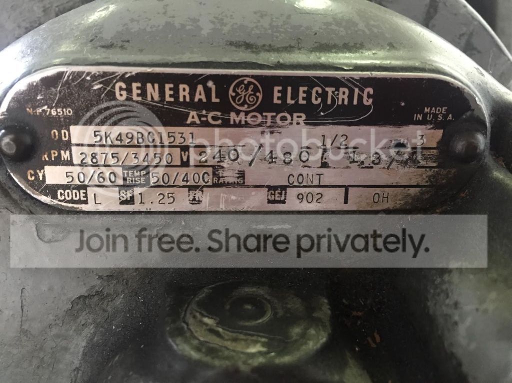

If I see a surface grinder that I like and it's 3 phase, I want to use the phase converter I have to wire it up.
Question - what is the practical implication of using a phase converter here to me as the user.
Are their power draw considerations?
Will there be any loss of performance with the phase conversion?
I think this surface grinder is a 1/2 HP , so I'll have to get the correct phase converter?
What kind of phase converter, static or rotary or "phase perfect" solid state?
it's a static
the maker says - "Because a static converter isn't a true 3-phase converter, your motor will only have around 2/3 of its rated horsepower."
I believe a static is ok for a surface grinder application, do you think I need a rotary?
thoughts?
No, a static is fine, it just won't develop full power and the motor may not run as smoothly, but it should work okay. I ran a surface grinder off a static for years. The amp draw isn't noticeably different and the converter doesn't really consume power itself. All a static converter does is start the three phase motor which then continues to run on two of the three windings.
I have a phase o matic static converter running my surface grinder. its a 3/4hp motor and the converter is rated the same as yours. I don't know enough about surface grinding to know how good a finish I can get with it but I do know it works. It spits out enough power that I've burnt steel and also sent a few pieces flying across the shop :D
