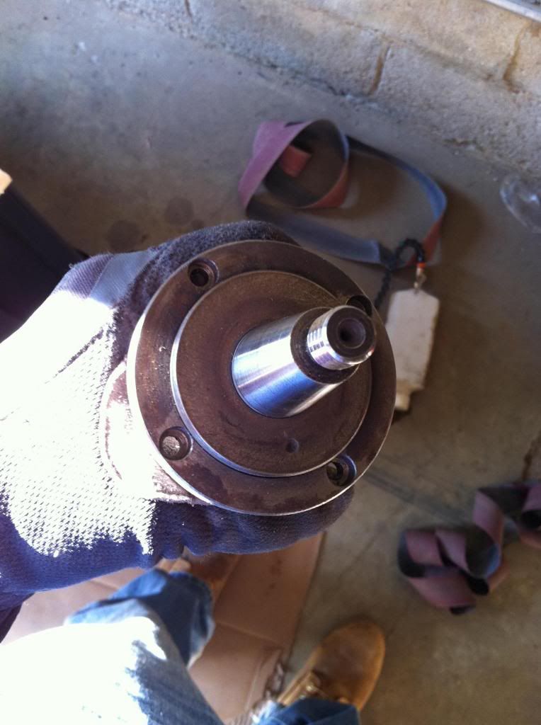

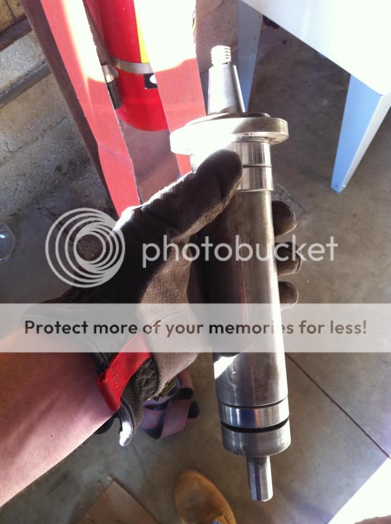

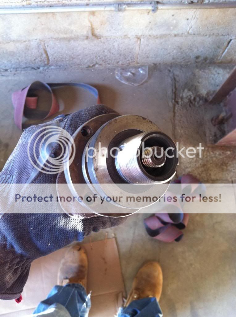

I picked up an old 612 Harig a few months ago and have decided to convert it to run on 2x72 belts for more rapid material removal+ tapering tangs on tomahawks. Im ordering a new 1.5-2hp motor (hopefully this wont be overkill and throw blades at the wall, but 1HP just seems insufficient with a 2in contact surface) and VFD for it and have a spare tracking and idler wheel for the conversion. Only problem is I can't figure out how I'm going to attach the contact wheel. I plan on custom ordering one from sunray or contact rubber in 100 duro with serrations.
What is the best way to attach a 2x7 wheel to this grinder? I've included some pictures. I would really appreciate some input on this as I'm completely stumped.

all you have to do is order your contact wheel with a 1 1/4 hole in it. or better yet a 1 inch hole that you can have machined/bored so that it will just slide over your hub adapter. machining the hole helps ceter the contact wheel on the hub so there is less material to remove to true the wheel and lessens the chance of vibration.
When I sent my wheel dimensions/specs to Sunray, it came back so close that about all I had to do was hand lap the bore hole a bit with some sand paper and tap it on.

So for the contact wheel should I attach it to the tapered arbor or to the threaded attachment that goes over it? I'm guessing the attachment since that's where the stone wheel sits.

The wheel just mounts on a Sopko adapter, then on to the taper.
Your second picture shows your spindle with an adapter half mounted to it...
