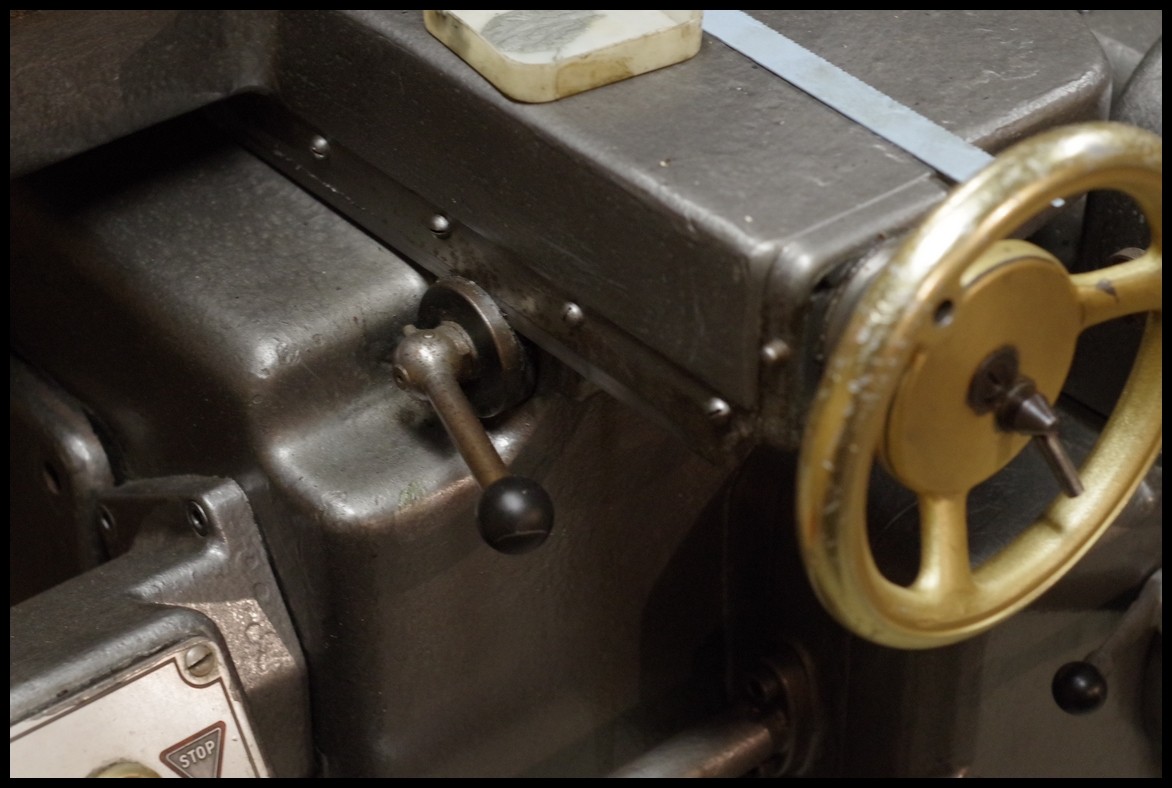

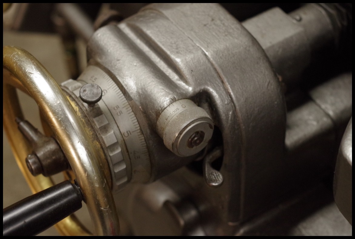

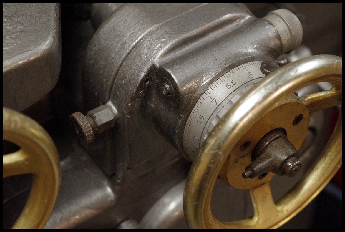

Some photos of parts what I need to know, what they are for.
1. Here I suppose is a micro-feed for cross feed ?
2. What is for this know in the cross feed wheel ? and this little knob on left ?
3. This is probably some blockade ?

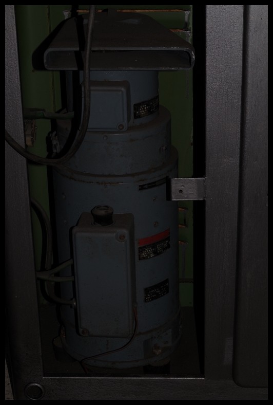

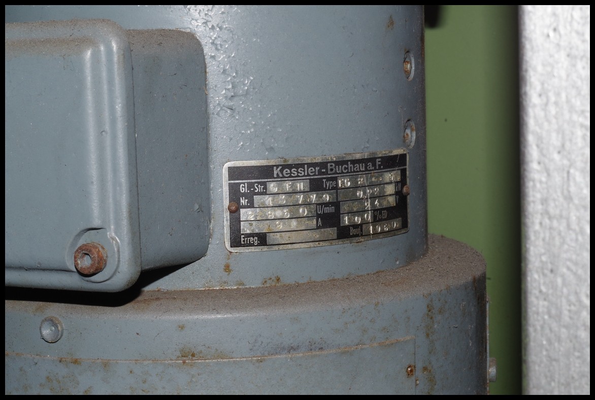

And I think about to make this grinder work with a good VFD ( siemens Sinamics or LG iC5 )
Here photos of labels on this "something like VFD" and on engine.

1) Yes
2) No idea, maybe a lock for hand feed.
3) appears to be saddle way lock, but not certain from photo.

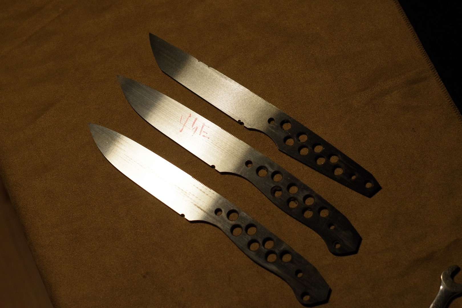

Grinder got Fogless mister for grinding coolant ( using a lot less coolant and mixed wit hair :) )
Using a new diamond with mouting block at 15* to dress wheel + fogless mister resulted in propper finish without chatter!
As 99A wheel ( clean Aluminium Oxide) is good for soft steel and carbon steel, this wheel totally don't like stainless and is dead when meeting Elmax/M390 ( this technology layer clogg wheel in seconds) but in Vanadis 4 Extra this wheel is Anihilated...
To grind all steels with one wheel I need to wait a month for box of newly made for order wheels with 59A AO mix 60I for grinding hardened tool steel.
If this will also fail for PM steels, then CBN will come to help. ( ou man this will be costly...)

Much better, those dark lines however are usually from overheating/burning the work where the thin stock is warping into the wheel somewhat. You can probably clean that up easily by making a final fine dress then another quick pass with very light feed. I'm guessing this is just a problem with high alloy steel and your stone however correct?
Did you grind these in sequence or all together? Looks like you ground them one after another, without redressing your stone between blades. The question will be, whether this finish is good for your process, and is quicker than redressing for a finer finish on each. Don't waste time on unnecessary work. I do mostly hand finishes, so I want as close to perfect as possible off the grinder for my ricasso, so I can hand sand immediately from 400 grit, because of this, I take very fine, slow final passes redressing between each batch of blades on the magnet. This may not be necessary for you.
Good work!
I was dressing after one side of blade.
This junk layer on steel quickly clogg wheel.
Dark lines are from clogged wheel.
With new wheel and wheel flanges + balancing this will be even better.
