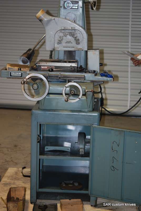

I just got a new Harig super 6x12 its a sweet machine paid about 1700.00 for it 1977 on manufacturer date. Had a walker chuck and a ton of tooling and wheels when we unloaded it.
I worked down some folder parts yesterday it was so awesome to have such precision and accuracy at hand, money well spent.

nice grinder what kind of accuracy are you getting?
I just got this last week after set up and dressing a new 32A Norton wheel it was nailing backspacers, lockbars, and blades all parts came off exactly to required measurement.
I picked this one up from Mohawk Machinery out of Cinn, OH, like I said it had all the tooling and Harig is still operational.
Upon inspection of the ways it is pretty obvious the machine saw little action, all the oringinal machining marks look brand new with no indication of wear.

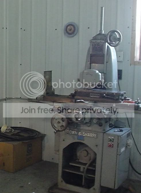

Here's my old beast :thumbup: She's a 1902 ;) Brown & Sharpe, still runs like a champ !! The thing is heavy like a tank, literally !!
I don't know how I would make knives without it. Virtually every knife I make gets at least a dusting, if for nothing other than to flatten out the ricasso/guard area.
If you're looking for a new grinder try to find one that already has a fine pole magnet on it. They work much better for holding down small knife parts. Blocking parts in with material that is a bit thinner than what you're grinding can be advantageous too. It prevents small parts from going into launch mode and also prevents exploding wheels :eek: Double sided tape works good for holding non-magnetic parts down, a little trick I learned while grinding carbon EDM electrodes ....... yuk !! Grinding carbon you'll finish the day out looking like a chimney sweep :o
Grinders that have the ability to run coolant are, IMHO, preferable to a dry grinder. Especially for grinding thin, hardened knife size objects. If you don't know what you're doing you'll end up with parts that are parallel for sure, but not even close to being flat. Two completely different things. It doesn't take much heat at all to cause warp on an 1/8" blade using a surface grinder.
