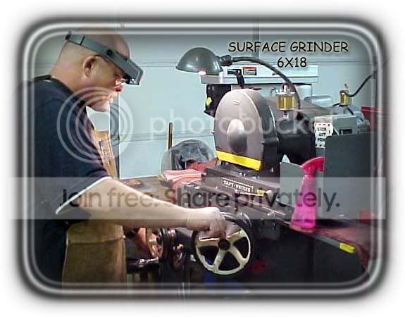

This is one I reworked back in 2004 and it is from the 1940's 6x18 surface grinder and works like a new one still today. If you can get a older one do so.
Terry
