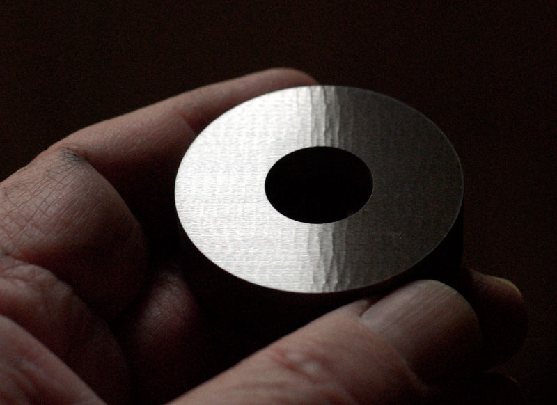

Basically no chatter marks and no ripples... A nice satin finish. On my old sg I tried everything OTHER than balancing the wheel (including side dressing) but still got the following finish. Ended up having someone look at it and they thought the bearings had lost the preload.

The chatter in the video I would agree with the assessment the bearings were shot. An out of balance condition that would cause that much wheel movement would be really excessive in a wheel that size and it would be noticeable in vibration/sound.
Use a 1/2" or narrower wheel. The narrower wheel reduces the amount of mass that can be out of balance. Let the spindle warm up for a few minutes before dressing.
I've never balanced 6-8" wheels and the only time I've gotten finishes like that was when the wheel got loaded enough between dressings to start hopping instead of cutting, but in that case it also caused heat discoloration streaks.
I had ripples like that when I put the wheel on the wrong way, even after dressing.
I turned it around and it produced a much cleaner surface

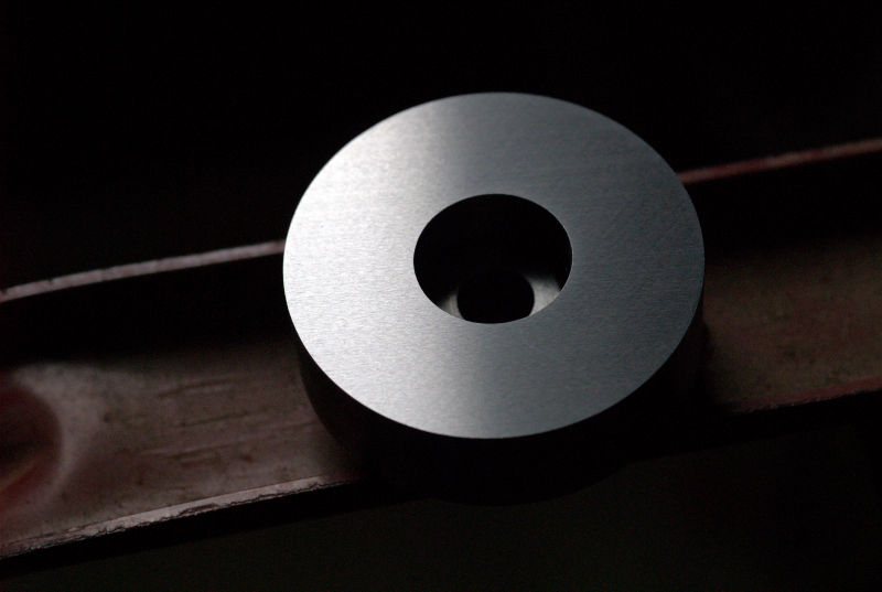

I'll see how mine does but this guy had great success balancing his small wheels (6-8") on his boyar shultz 6 x 12... check out the before and after below - the latter is what I want on knife blades hehe

ALL surface grinder wheels should be balanced when installed on the flange and dressed during use if you want professional results, but hey, feel free to not listen to me.
Thank you for confirming that Kevin, I feel the same and have heard that nice wheels even from Norton and such aren't balanced from the factory.
