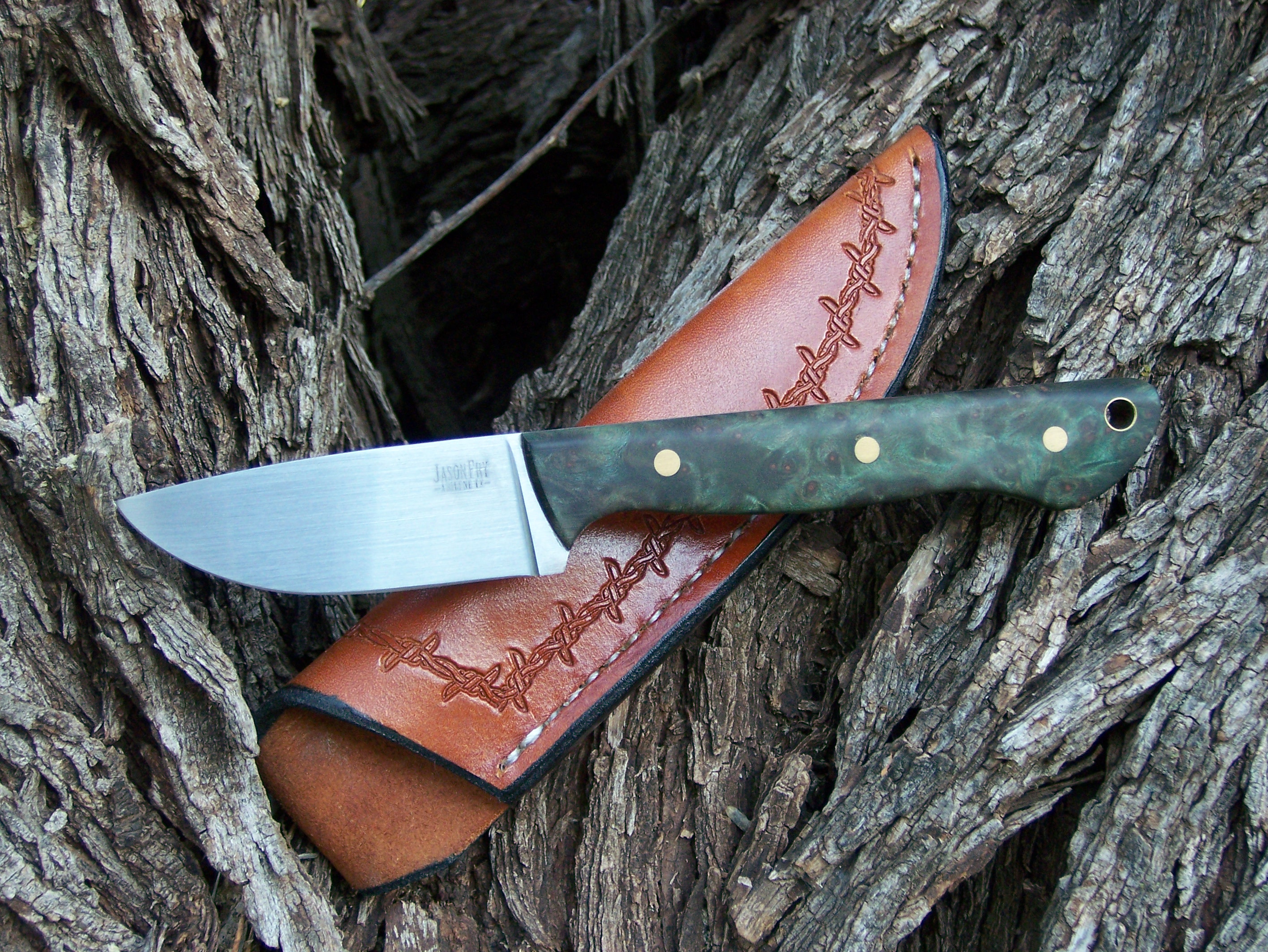

Well, depends on if he's skinning squirrels or moose, and if it's also a field/hunter or a dedicated skinner. I guess in general, skinners have more sweep or belly in them. 4" blade is pretty common, though, some are only 2" of so. Here is one that I have made and has been quite popular.
A pretty good little skinner, but maybe not so great as a hunter.
This guy primarily does deer but is not shy about small game either! Maybe I'll make him a 4" skinner and a Bird and trout too?

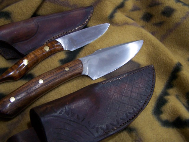

I just finished this one for a friend who breeds Great Danes, which we have two of. The pic is terrible. The fluorescent lighting reflected horribly in the sanding marks, which are actually 1000g. They look like 50g in the picture. The smaller knife is an EDC for his wife. Please don't laugh at my sheath work. :)

Thank you all! I think I know the direction I am going to go with this one! Something along the lines of what Jason Fry did with a full flat grind and a pale yellowish/green G10 slabs! Thank you all!!
A set like Willie made is a very useful pair of knives. With a little skill, you can make a duo-sheath that holds both.
Thanks Stacy. I really appreciate that. I didn't finish those super nice as they are truly going to be used as EDC knives, but they do look a lot better in person than the pictures. The lighting in my house is quite glaring as both my wife and I have SAD. The intense light makes taking pictures of high contrast items difficult. I am finding a lot of people are asking for a raised clip that is sharpened. I have done 8 of them now.
I was not specifically referring to the harpoon blade, but in general to a larger and smaller hunter set. A set like that can do most any chore from breaking down the deer to cleaning a quali.
