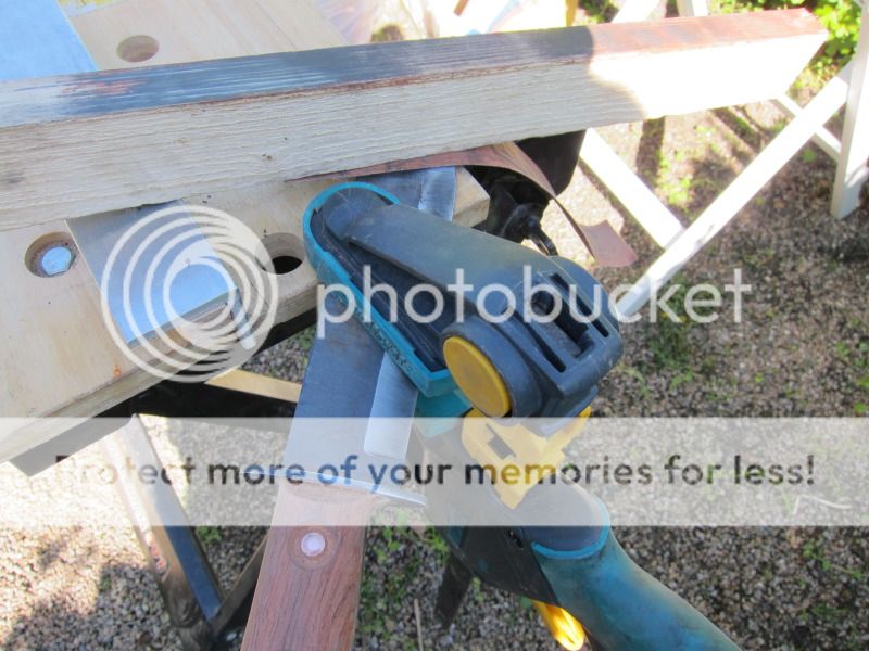

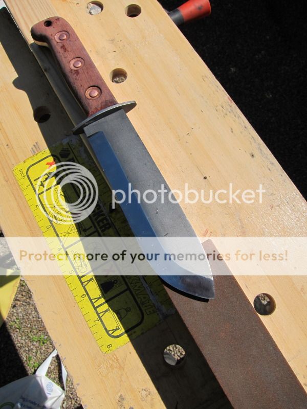

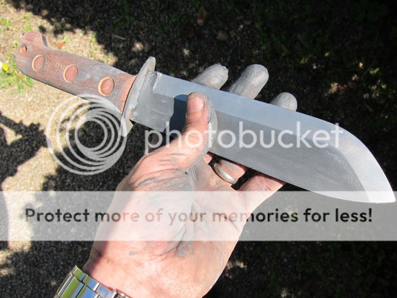

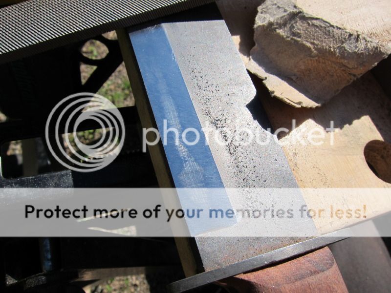

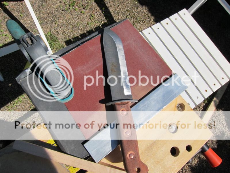

I wanted to give this knife a quick makeover. But as usual when the foundation is dodgey you have to dig deep. 6 hours of manual work deep.

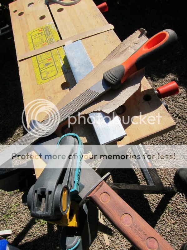

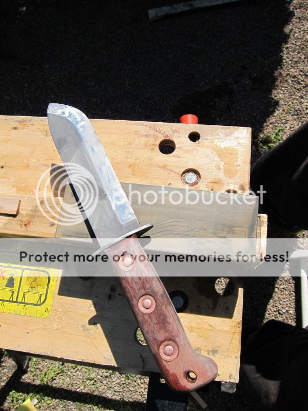

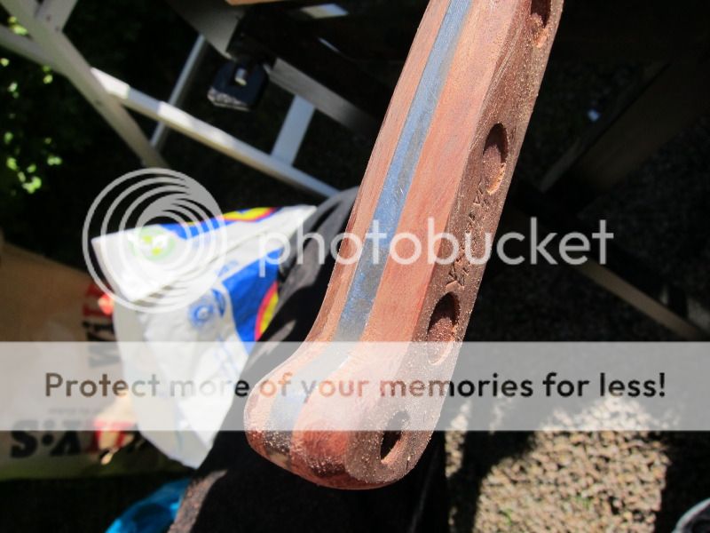

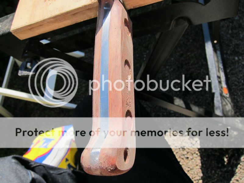

I started of shaping the handle whit a file and 120-papper.
Baby steps. I did not want to loose the shape and streamline it so it will be hard to hold on to while chopping. And I did not want to put a finish on it, its suppose to be raw.

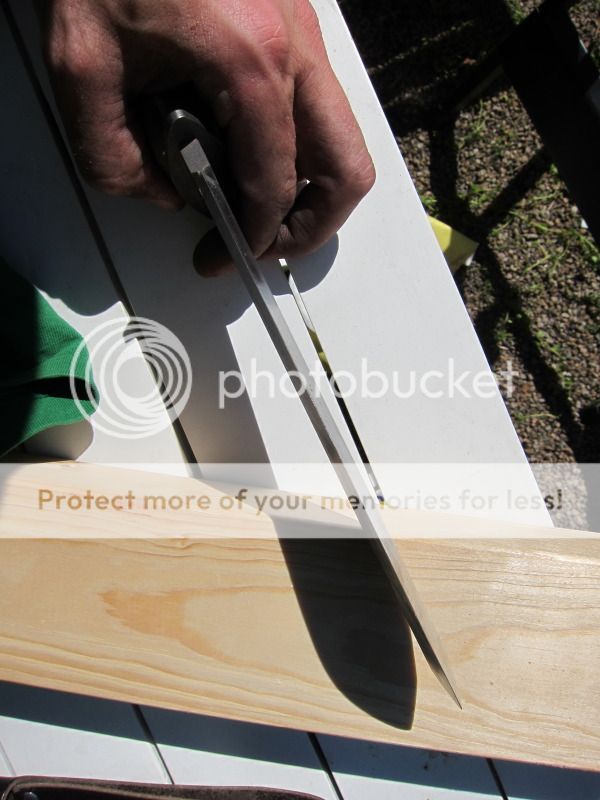

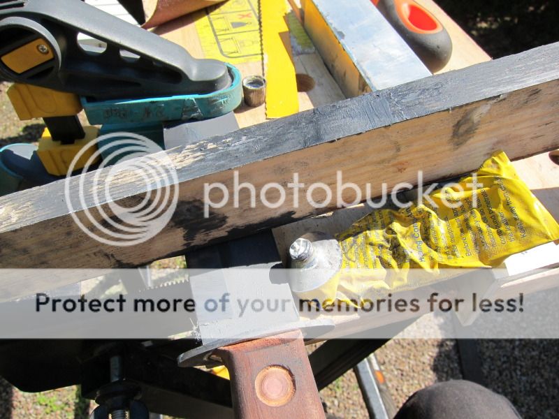

Then i intended to give it a even bevel whit sandpaper.

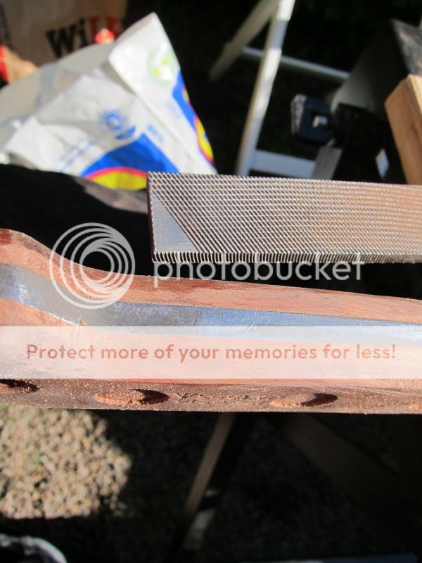

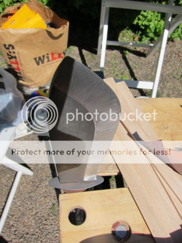

But the hollow grind was so ify and the secondary edge so uneven that i decided to re do the hole thing.
The Öberg-cut bahco file really did a nice job.

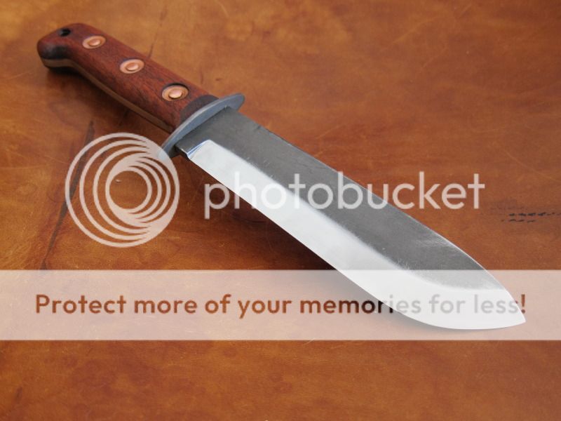

The knife is reborn or born.
This is when i should have stopped. The rest is just me getting caught in a sharpening frenzy. :)

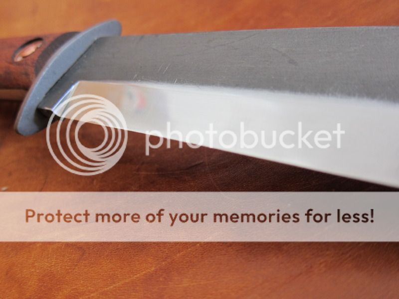

So i went straight to polishing.

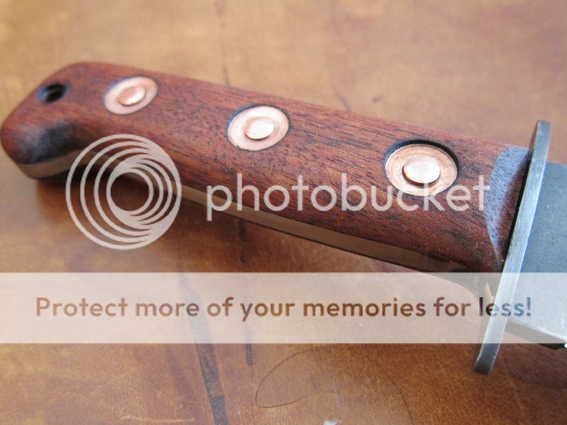

Water stones for the finishing touch 120, 340, 800, 8000. What i should have done to save me time was to go up to 800 whit paper, strop it and be done.
Handle sanded up to 320 whit scrap papers and the linseed oiled. Blade stropped on a leather belt whit red rouge.
It might not look that different but it actually feels like a capable knife now.
Befor it had a folded an painted over edge tha did not cut. Now it slices whit the best of them. :)
I really like the ergonomic of this knife, Nice work! What kind of carbon steel is made of?
Feels like a 55 or less hrc spring steel.
Edit: 54 hrc British 1095 carbon steel with a % of nickel.
Thanks! I´m really happy whit how it turned out both how it feels and looks. Its going to be exiting to see if it preforms next week.
