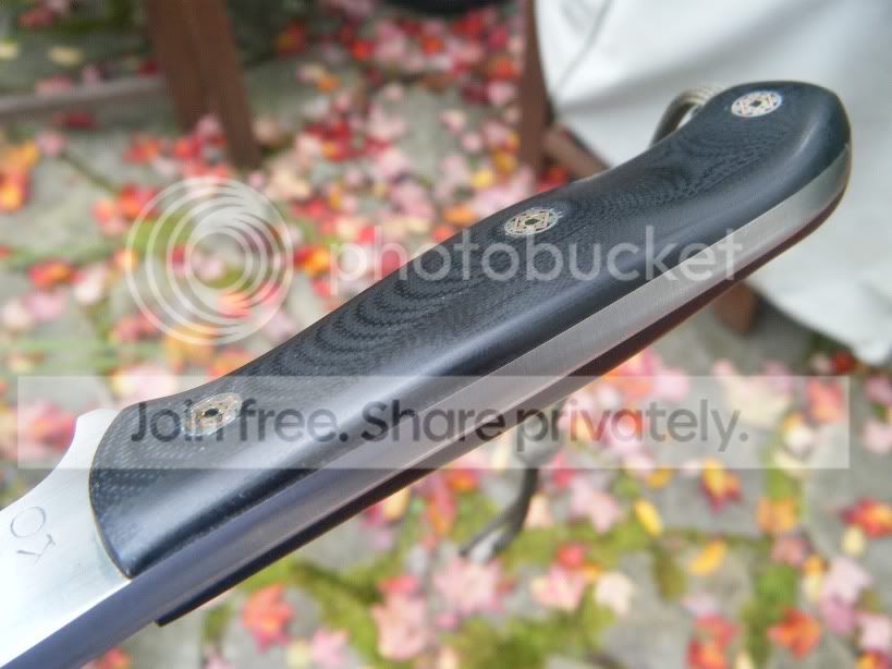

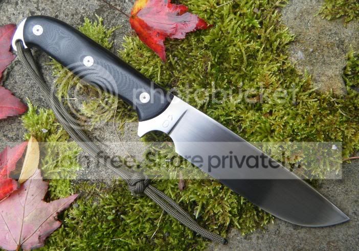

All my knives are made by hand. I just recently started using an angle grinder to save some time for cutting the profile and rough beveling. You might consider buying one as well - very cheap and powerful tool. Finish the profile and bevels with a coarse file, then a finer file, then sandpaper. Here's an example of the result:

defaultuser, that is gorgeous. Really nice work. That's actually just the type of thing I had in mind.
My original idea was to powdercoat or park the blade, but examples like this I've seen here in the last few weeks have just been too nice for me to resist.

Is there anything beyond aesthetics behind having a clear angle between the back of the blade and the edge vs. a smooth transition? I thought the angle was done with thick blades, but defaultuser's picture looks to be very thick, yet transitions smoothly.
The grind depends on the intended application, not the thickness of the blade. Here's a page explaining the different grinds. You can't make a hollow grind blade with files, but all the rest a doable; scandi and "saber" (high flat) are probably the tricky ones. The blade in the pictures is a very slight convex, with a secondary "v" bevel (the edge). Have fun!
