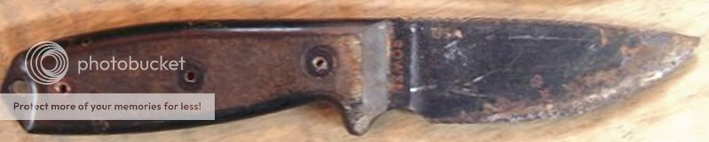

I don't believe you need to be thinking in terms of months or years when it comes to protecting these sorts of knives in real world / protracted usage. Someone posted up the below here not so long back. That didn't take long to turn into a wreck when conditions included damp and wet too.
Whilst you could use animal fats and oils personally I'd swerve that. The most immediate things that spring to mind include: Rub Vaseline on it, or lip balm, or a candle, or a paraffin burn dressing...and so on. I like clean gear, the last thing I want in the sticks is a case of something nasty from some rancid old muck.

can you post a link to the thread that picture came from - I'd like to read it.

i'm pretty sure that's the knife Jeff gave to a dude in peru, right after the partnership with Rowen. it's been used in a jungle daily since then.
It may look like a wreck but I bet it's got years left in it and is perfectly functional. After five minutes spent with a stone and steel wool it would probably look pretty good too.
Simple carbon like 1095 will acquire rust in a heartbeat if you let it sit wet. After cleaning surface rust a couple of times remembering to wipe it dry after use would become second nature so it shouldn't be any problem.

Ramm9, hola
I agree, it doesn't look too far gone to be salvageable, a belt would make short work of stripping that off. That said, unless I wanted to make changes to the shape I'd probably dunk it in something, perhaps a molasses bath that many metal detectors use to recover dug up rusty stuff to good effect. That makes sense to me from a recovering investment point of view. Me personally, I'd just toss it in the bin. It has demonstrated an undesirable tendency that I don't anticipate it quitting. I can control for that, because it is predictable, by simply avoiding it.
It's a RAT-3 right. I would be curious to see what it would look like after a soft steel brush and some steel wool cleaned it off. How deep any pitting is and especially if there is any rust under what is left of the coating. Interesting if the scales could be removed and see what's under them.
It does have that tendency. You could probably duplicate the look on a used knife that has some of its coating rubbed off and a few scratches in the blade by sticking it in some wet mud for a week or two.
Still, if it was all you had for the year out some pitting wouldn't keep it from functioning after you ground a new edge into it.
