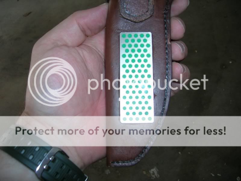

I have epoxied the pocket DMT's on the back of a sheath or two. It doesn't get in the way at all, and is pretty handy. Just have to be careful and not slice up my sheath.
I think that's a great idea, thanks.
