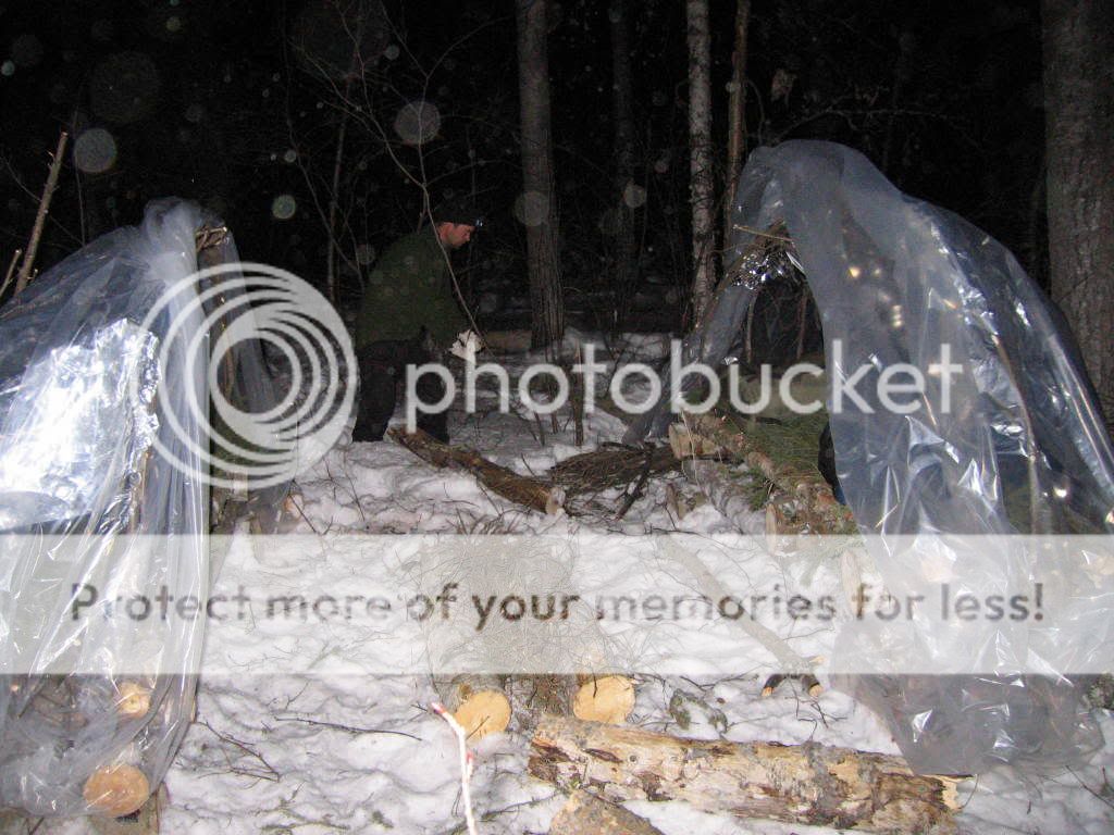

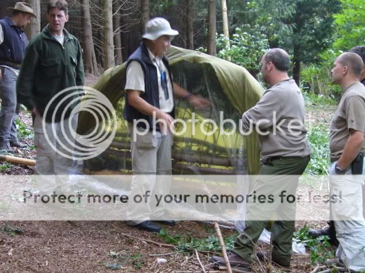

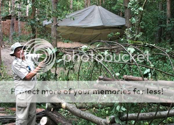

I have a few pictures of them under construction and in use.
Its all described in a rather unassuming, but truely excellent, little booklet titled "The Two Kilogram Survival Kit Field Manual" http://www.karamat.com/books.html
"The super shelter concept is based on the physics of trapping and holding warmed air as in the Innu snow hous, combined with an open fire for providing warmth. The super shelter allows you to sleep in your clothes in sub-zero temperatures without a sleeping bag. It is mad up of inexpensive and readily available materials. A single person shelter weighs less than a kilogram and easily fits into a large parka pocket."
