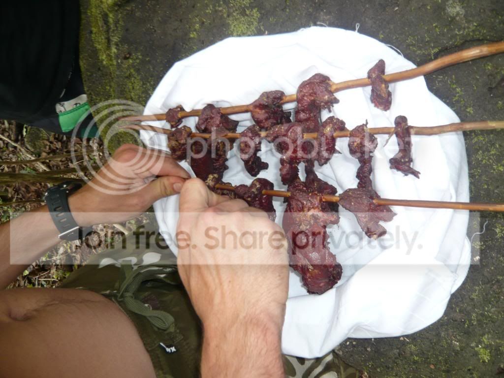

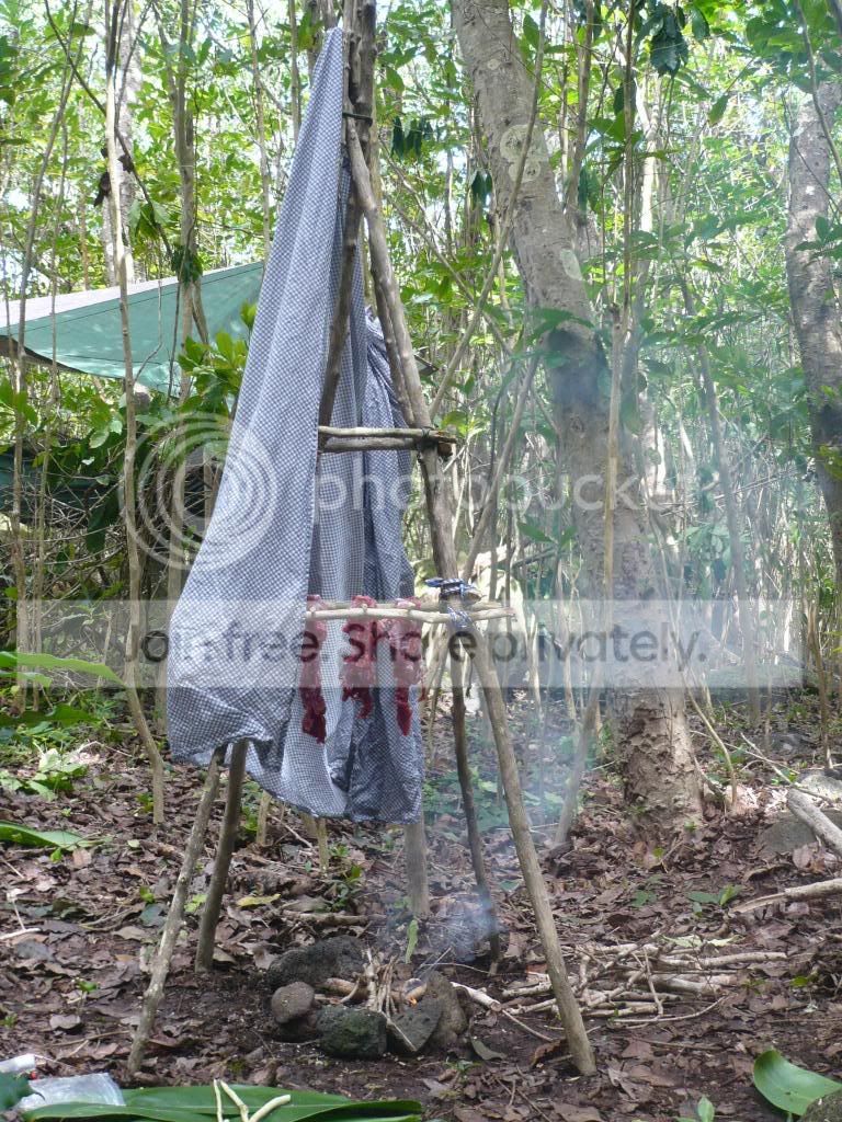

I was able to make it out for a few days backpacking this last week. I had a chance to construct a smoker with great results. I used a small bedsheet but anything, including a blanket or tarp can be used with great results. I constructed a simple four sided pyramid about 6ft tall and tied in some horizontal supports. The sheet wraps around the frame nicely and leaves about a foot and a half underneath for airflow to the fire. I ended up blocking three sides of the bottom with ti leaf skirts to concentrate the smoke.

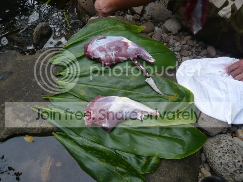

The first evening in camp I hunted for about 2 hours and was able to take down a nice 40lb nanny for meat. The next day was spent smoking meat and harvesting wild Tahitian prawns. This salted, smoked goat meat would last at least 4-5 days without refrigeration.

Great post. I've tried this with jerky slivers just near a smokey fire and the results were OK. I've been planing to try exactly what you've done for some time. From your pics, it looks like it worked well.
Neat, that's making me hungry for sure! I've never made one myself. How long did you leave the meat 'on' roughly? How far above the fire did you keep it?
That looks really good! :salivating:
I would like to know how long it takes as well. :confused:

Thanks for your post and the pictures. I have never seen this done and still have some questions.
  • Was the meat seasoned or treated with anything prior to smoking?
  • How long did you smoke it? (And how did you know when it was done?)
  • How did you keep the fire going without it flaring up and igniting the sheet?

Yer makin me hungry! Nice little smoker ya made man. The jerked meat will last longer than the week if you dry it all the way. Looks like ya left some moisture in it though. mmmm nice and tender.

Man oh man that is what i call wilderness at its best. Now where are the pics of the prowns???? I want to know how did you cook them as well. Did you go out there by your self??? When you are done with the meat, Do you eat it as is?? or do you cooke it later on.
As for the guys on here. I dont know about you but i did notice they like pics and recipes for food alot more then knifes. Goat meat is one of the best out there. Where about in Hawaii are you ???

Not Evbouret, but I thought I'd chime in. I'm no master smoker either, having only experimented with it a few times, so ymmv. Please feel free to correct any mistakes I've made, but so far I'm still alive!
If you smoke the meat properly then it does not need to be cooked. Trim off excess fat to prevent the meat from going prematurely rancid and cut the meat into thinner strips so that it dries quicker and more evenly. Fat is hard to come by in the wild so cook it in a soup and enjoy!
I prefer the Dakota Fire Hole method of building a fire in a small hillside (flat areas work too, but I like the hill method better) and the "chimney" runs through to the top of the hill letting the smoke out, minus the fire and high heat, which can cook the meat instead of smoking it. This also prevents the wood framed smoker and cover from bursting into flames, which I have done, so you don't have to watch the fire as closely and allows you to do other things while smoking. For the cover I've built small frames and used my jacket or a blanket and I've also used banana leaves and elephant ears in more exotic locales. Maybe pine boughs etc. would work, but it could add a piney flavor to the meat. Add hardwood of your choosing (you may need to soak the wood to prevent it from burning), and avoid softwoods and resinous woods (and toxic woods like Oleander, of course) which taint the flavor of the meat. Check out "Dakota Fire Hole" on Google Images for a better idea of my very poor explanation.
I've typically smoked it over night, so probably around 10 hours or so. I check it occassionally and when it's stiff and starts to break when bent then I call it good. This means the moisture has been driven out and is ready for longer storage, but it's no longer tender and juicy. For immediate consumption pull it off when it looks good, but I don't know how to check to see if it's properly cooked enought to kill nasties.
If you build your fire hole in a small hill then you can stack your hardwood near it and sleep close to the fire (preferably with a reflector wall behind you too, of course) using the fire hole as a reflector fire and just reach out to replenish the smoker wood as needed without fully waking up. The chimney effect also draws the smoke away from you making things more comfortable in that regard also, so you don't get choked out while trying to sleep.
FYI: smoked meat is dark red and doesn't looked "cooked." If you have doubts, cook the meat. Tear it into strips and throw it into your stew. Boiling will kill any bad bacteria.
