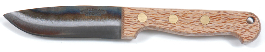

Basically, my question is simple. Does anyone have one of these? I have been scouring the web for reviews and impressions of the knife and have come up with a grand total of two threads about them so I would like some opinions on the knife from someone who owns one (or has used one). For reference, this is the knife I am talking about.
Basically, I've been looking at getting a 4 3/8in tough bushcraftish knife while I wait for the Becker short series to come out (I've got my eye on the BK17). I've been looking at this svord drop point hunter, as well as the Condor Bushlore or sapien (but thats for another thread) but just have basically no info on it. For instance, I know the tang is full length, but its not full width... but exactly how wide is it? How is the L6 steel? How thick is it (heard one reference to 2.5mm, but thats it)? How does it handle? Things like that is what I'm wanting help with.

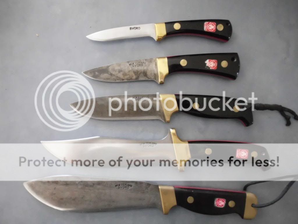

I have almost every model svord make and use them as my main hunting knives. I have found a beveled edge of about 30 to 40 to be the best compromise between edge holding and sharpness wich is still hair spliting.
From shot to the butchering stage of a white tail size deer (Fallow) it will do it easy. A few wipes on a leather belt will bring it back to hair poping and that will get the venison in the frezzer.

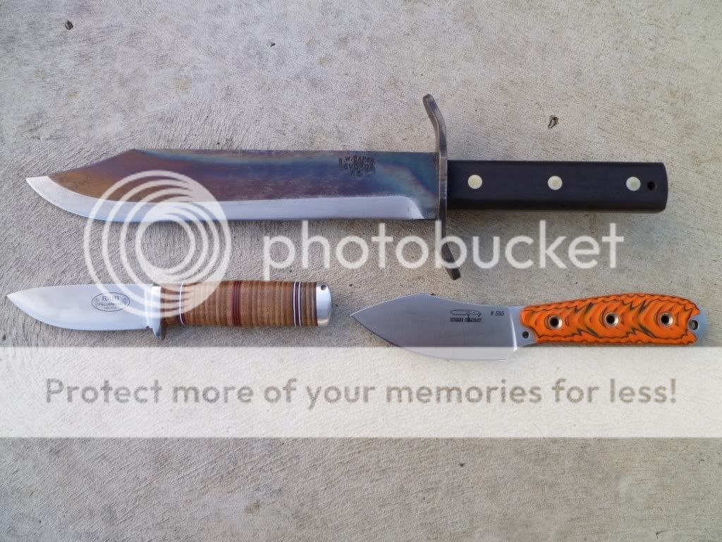

Svords L6 is one of my favorite steels. My Svord Von Tempsky Bowie will out chop and hold a edge as well as my Busse BM.
Here are a few of my favorite Svords. Even have a few customised ones.
Even when bluntish the knife will still cut very well because of the thickness of the blade.
The mighty Von Tempski Forest Ranger Bowie.

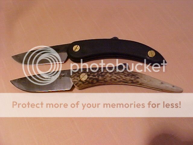

My custom Pesant in a Red stag brow tine.

I have the drop point Svord and had planned to do a review but other distractions like work have interfered. I will try and answer a few of your questions briefly and as best I can.
The tang as you say is not full width and is not quite full length but ends roughly where the thong hole is. The tang is exposed on the top of the grip only. I have no idea how wide it is but assuming the rivets go through it I would say there is a lot of metal inside the grip.
The blade is quite thin and has a bit of flex. Without measuring it exactly I would say it is around 2 to 2.5mm. This is no heavy duty chopper but would be adequate for most camping and hunting purposes.
Handling is a subjective thing - the grip is substantial and secure and is ok for general kitchen use. It suffers from the usual problem of thin blades in that it can be a bit uncomfortable if you extend a finger or thumb along the spine and apply downwards pressure.
The blade comes delivered with colourful hues from what I guess is heat treating but this is not durable and wears off quickly with use. Mine was reasonably sharp as delivered but a bit less so around the tip. It stains easy but no more or less so than most carbon steel knives. The wood on the grips on mine is a bit nicer than the one in your pic. It is coated in some form of varnish/synthetic semi gloss finish that is functional but had a few big blobs on the butt end that I cut off.
Edge holding has not been a problem but has not been outstanding. The steel is good but don't expect miracles from it.
The knife came with a heavy duty leather sheath that is too long for the knife. It swallows the knife with only about a half inch of the grip exposed and it is difficult to remove one handed. I intended to shorten the sheath by cutting some leather away at the top and restitiching it but the slit belt loops are right near the top.
Overall not a bad knife.
