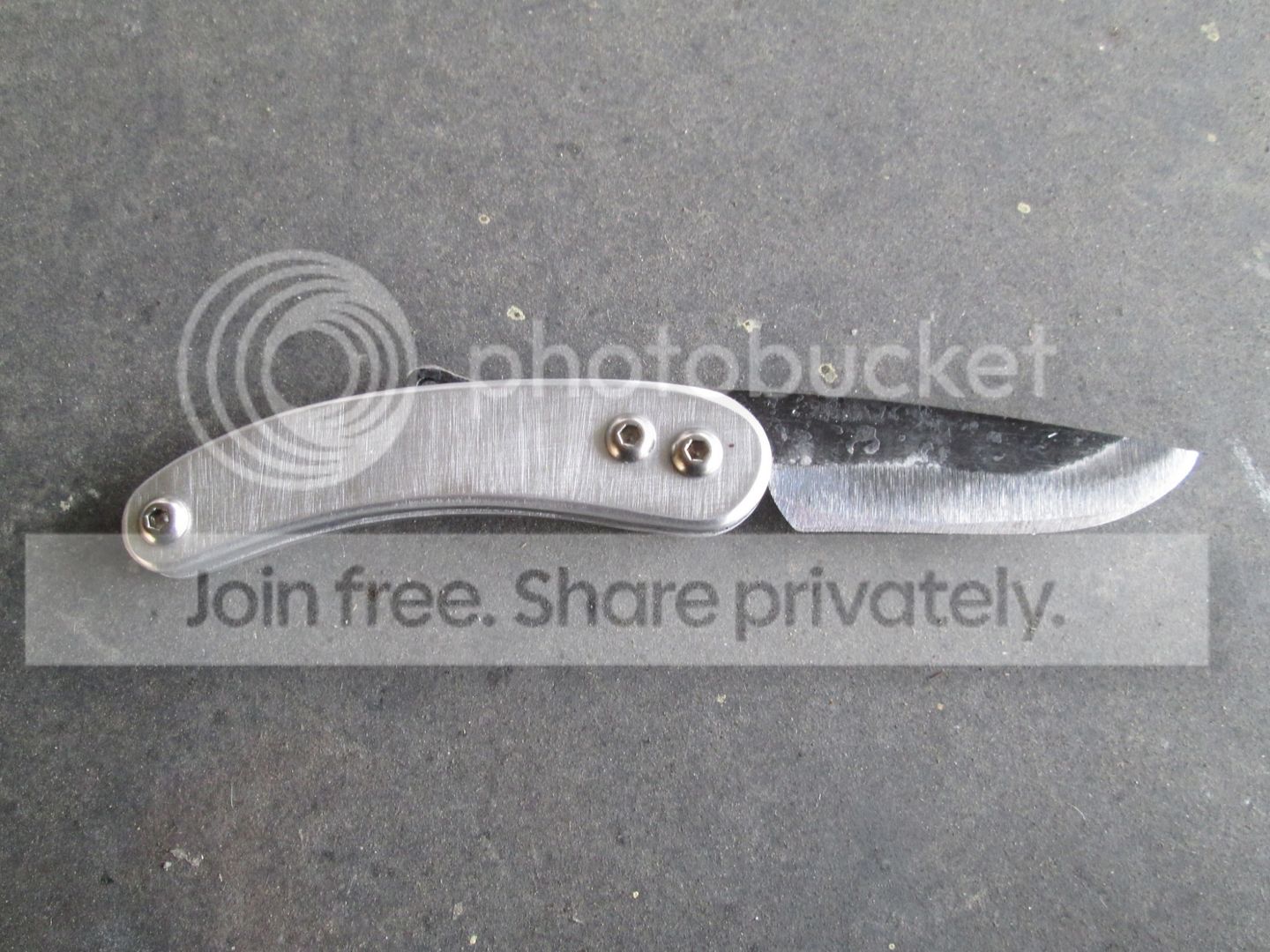

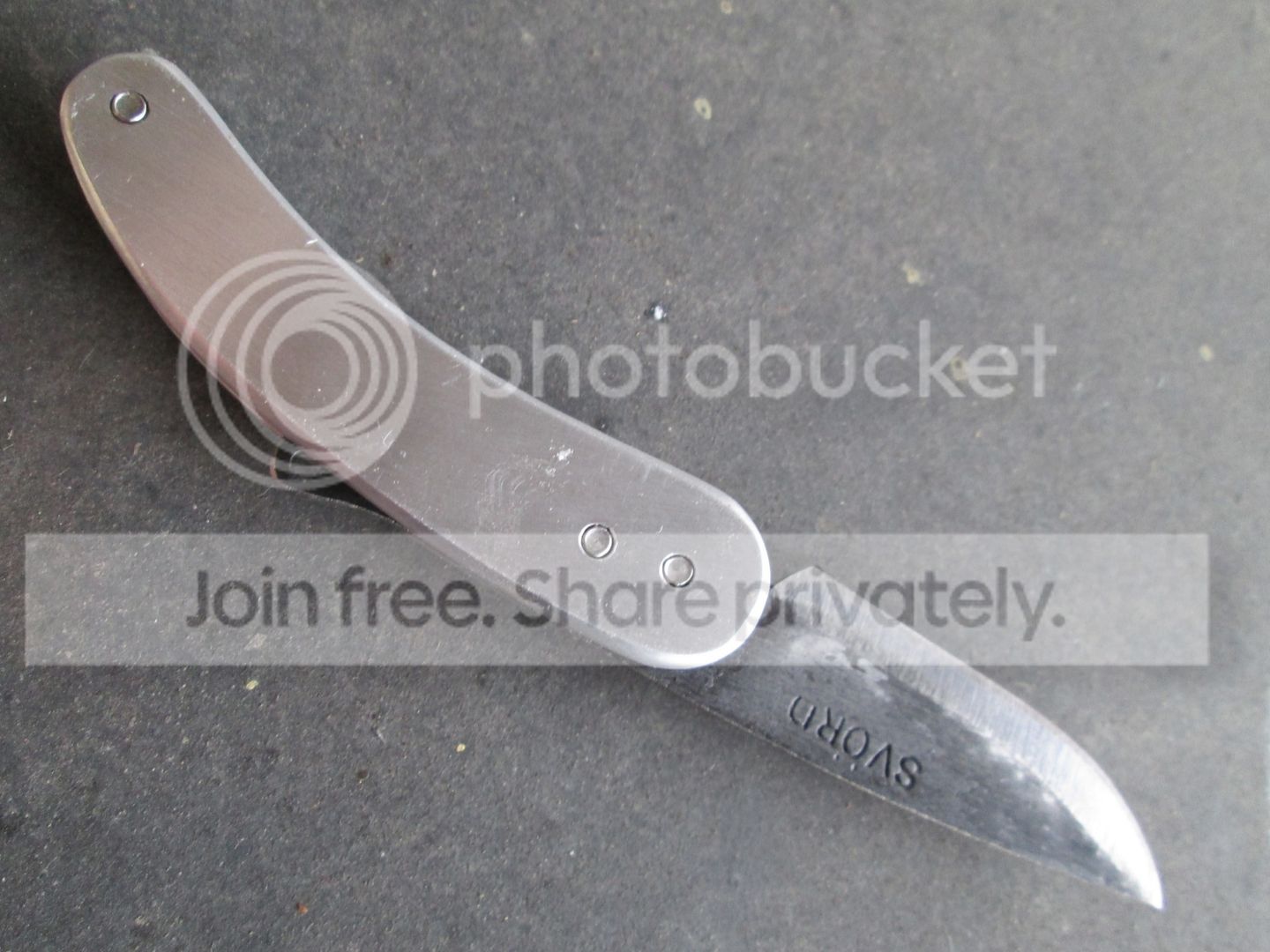

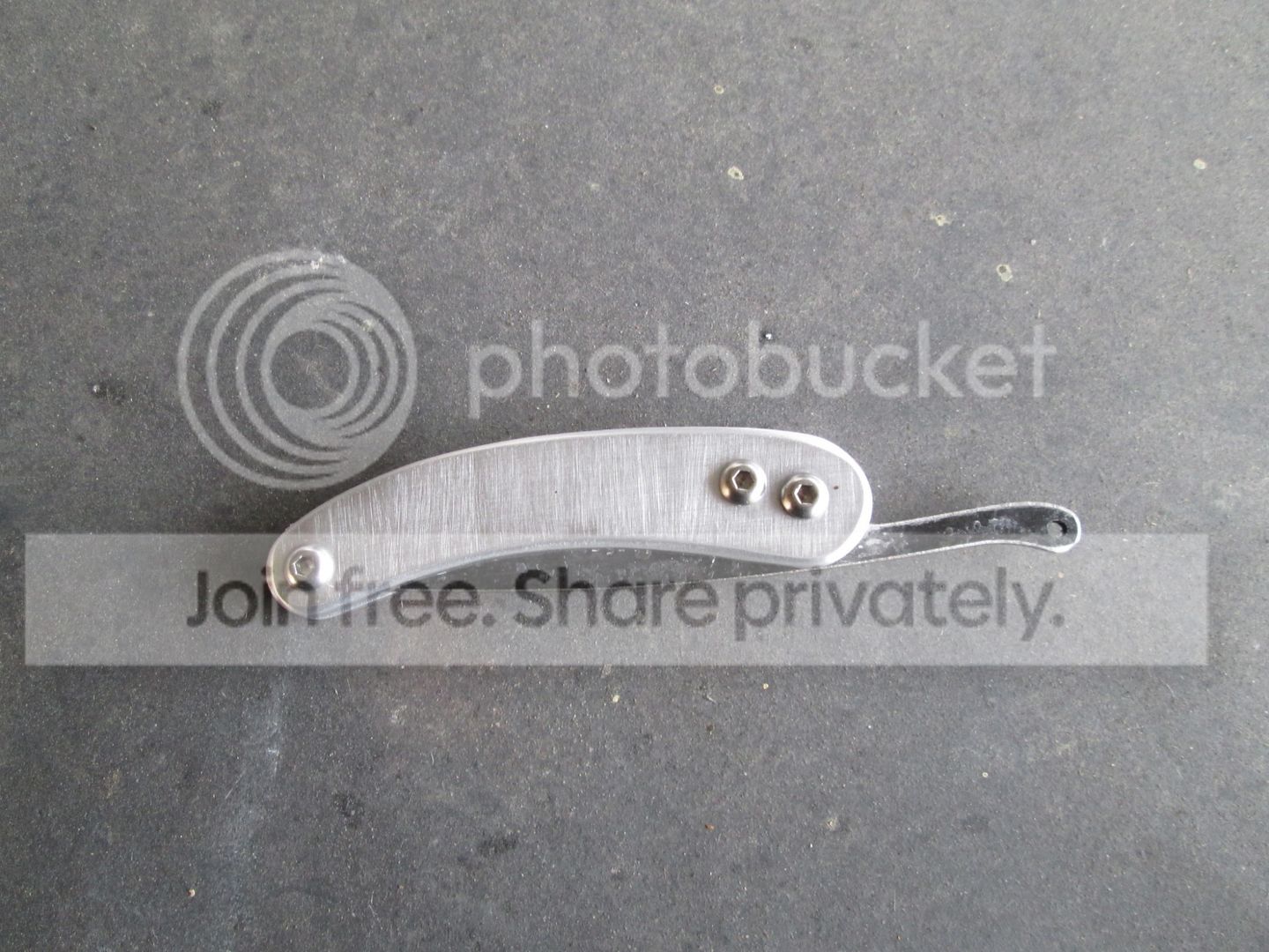

I made some aluminum slabs 1/8" thick. I believe the factory slabs are 1/16". Then I got a 1/8" I.D. o-ring and installed it. I got the knife adjusted just right and used removeable loc-tite threadlocker on the screws (M3). I then used a hot wax treatment on the pouch to stiffen it up.
I really (really) like this knife now. I've been wanting a watch-pocket frikkie for a while and this one is sweetness.
