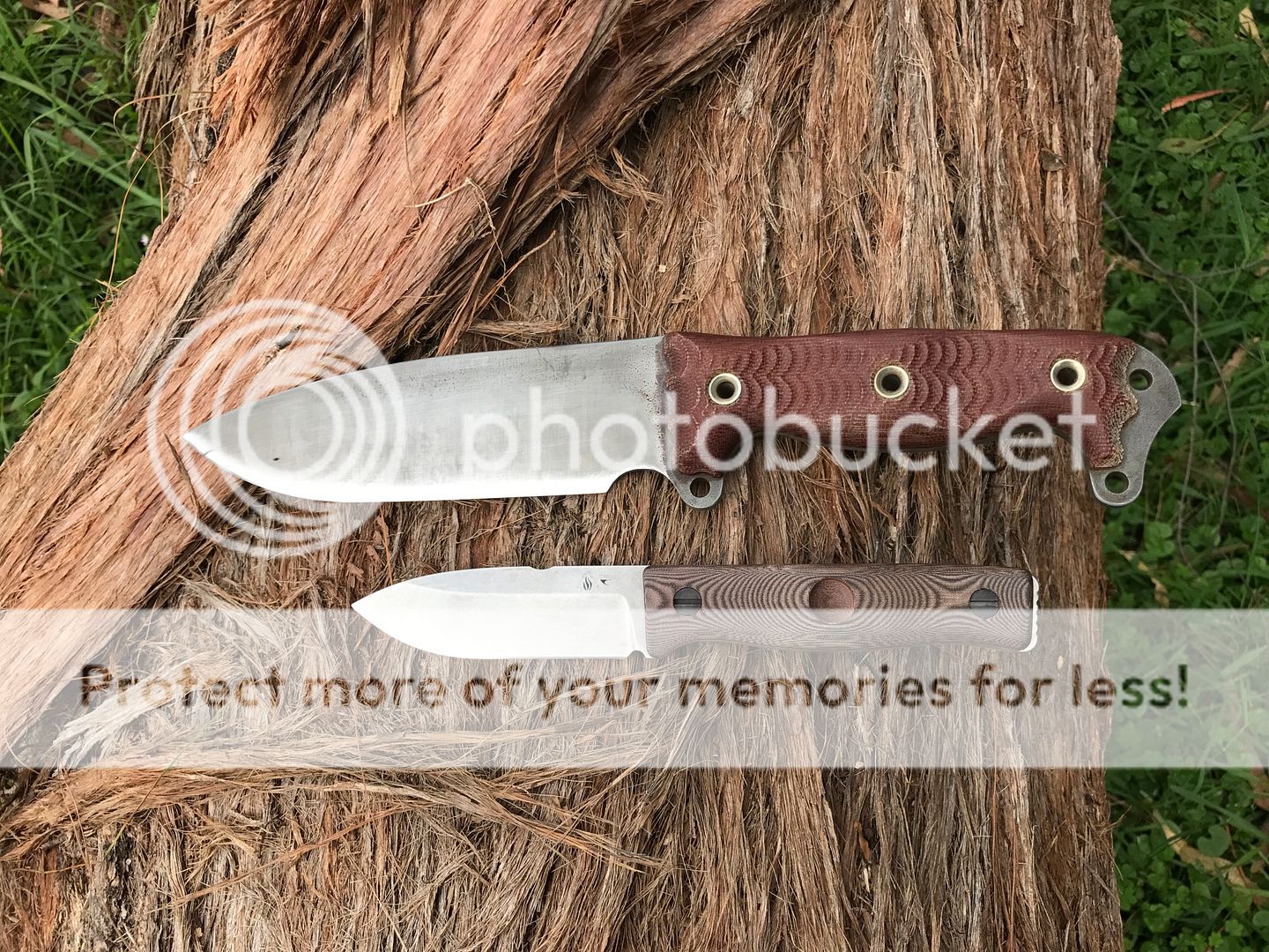

Managed to grab a BG Public Defender off exchange and I'm pretty happy with it, thin and light for a Busse. It's gonna get stripped for sure.
