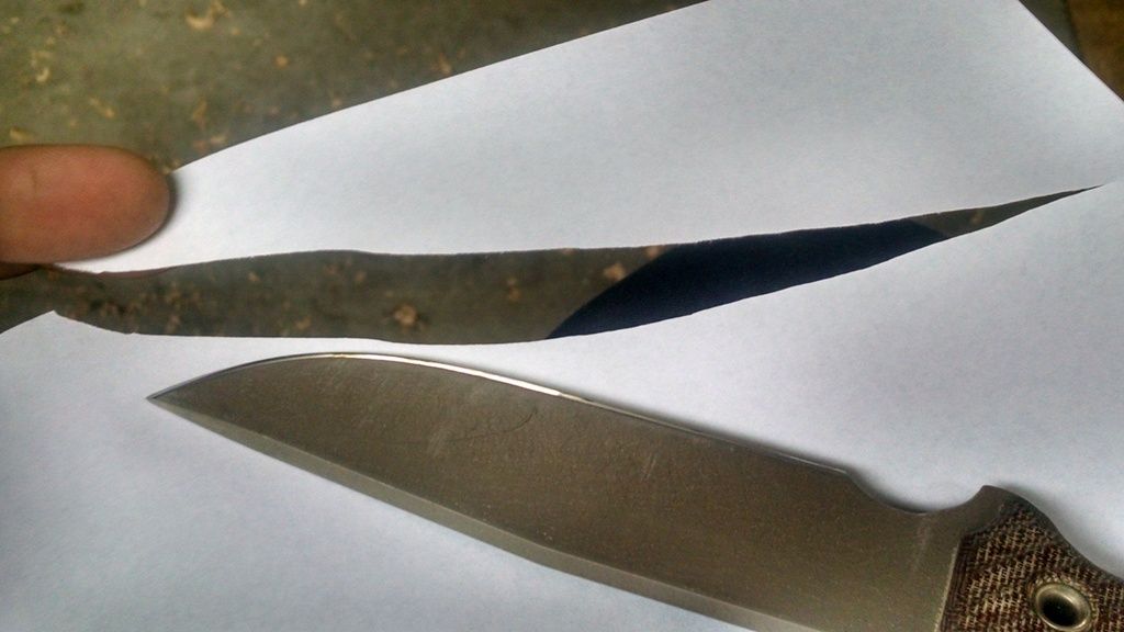

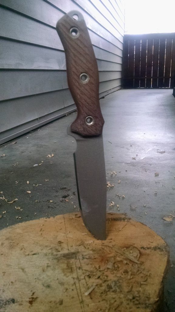

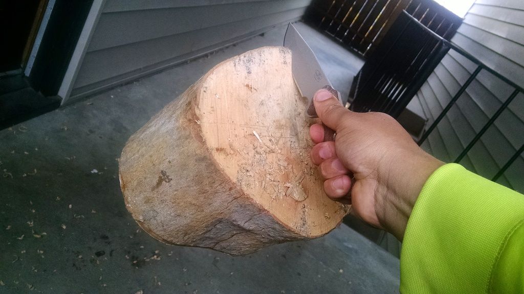

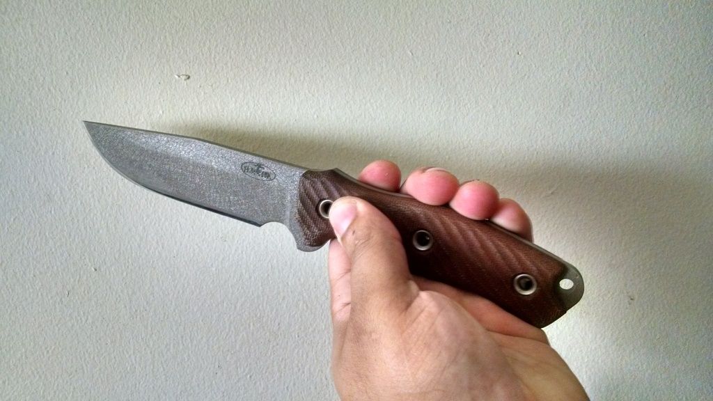

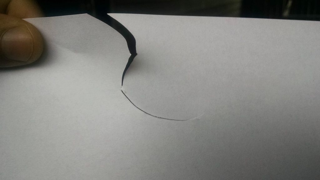

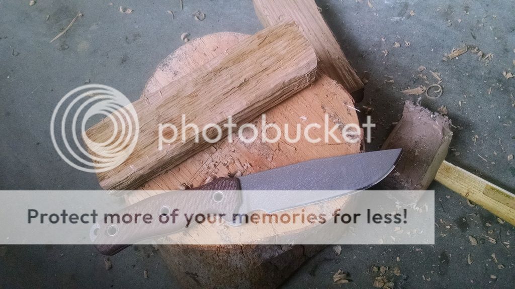

I can't wait for this...... Nice job. What stones were you using please. I'm always interested in people's choice of progressions.

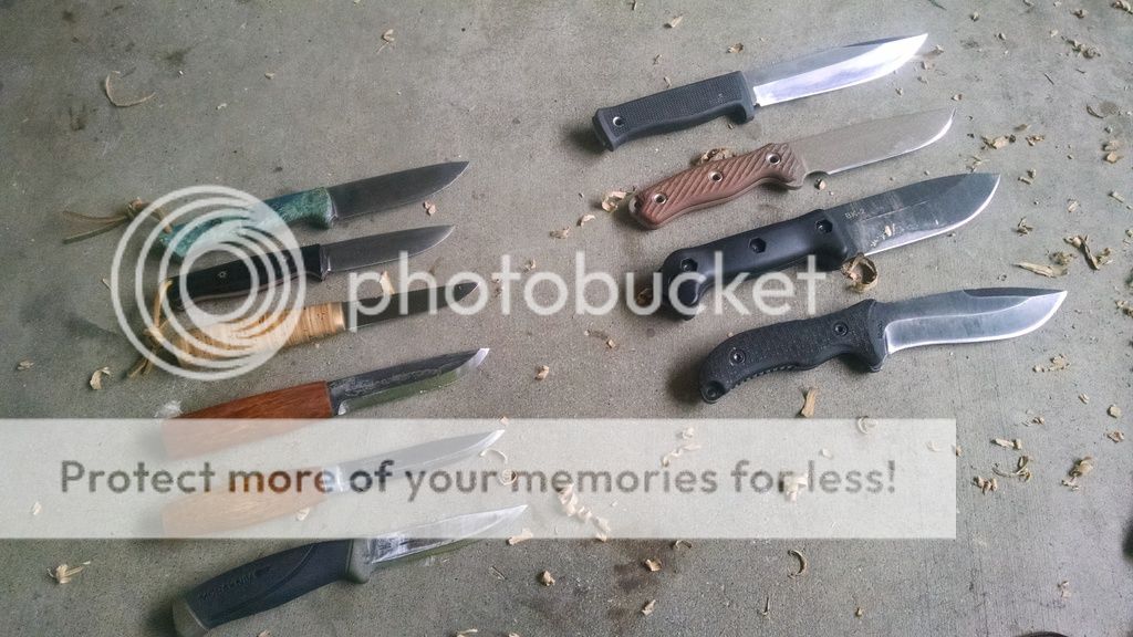

Nice one man, I like watching your progression through the steps. I kind of like Swamp Rat knives, when I get them used after someone else has fixed the edge and acquired a sheathAnd I really like 52100 steel with a great heat treat. I am more curious about who makes that birch bark puukko though, and am looking forward to your thoughts on the new A-1. Which reminds me I should get on with re-handling the A-1 I have, I miss using that knife.
Looks like you've tested the heck out of that swamprat, Thanks nice review. I used to have an older Ratweiler I still regret selling it as it was easy to sharpen and held a nice edge. I just wished they would offer them without the choil's that's my only complaint. I do like them other than that.
Thanks Brian, haha yea, keep those eyes peeled in the b/s/t
The Puuko is make by Daniel Knives here on bladeforums in the knifemaker section, great blade, also 52100.
Can't wait to get that new A1.
Rehandle ah?

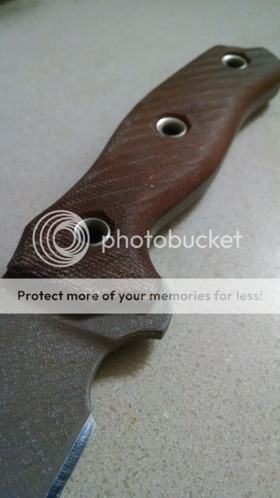

I've always been intimidated by the hidden pins in the handle, I just don't know how they work.
Thanks for the info, I will check out Daniel Knives.
Not really any hidden pins per se in the one I have, the lanyard hole was the only actual pin, the rest is just notches in the top and bottom of the tang that the Kraton molds into. Just drilled out the lanyard tube and then cut one side off the handle with a sharp boning knife much like filleting a fishGoing to make it a hidden tang with micarta with a stainless hilt.

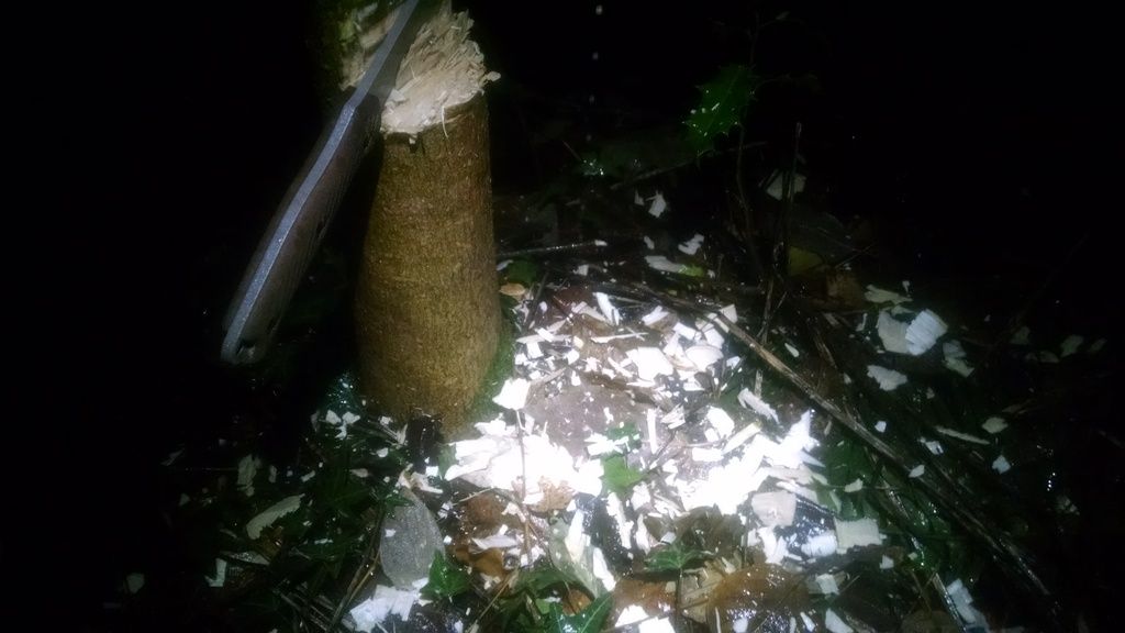

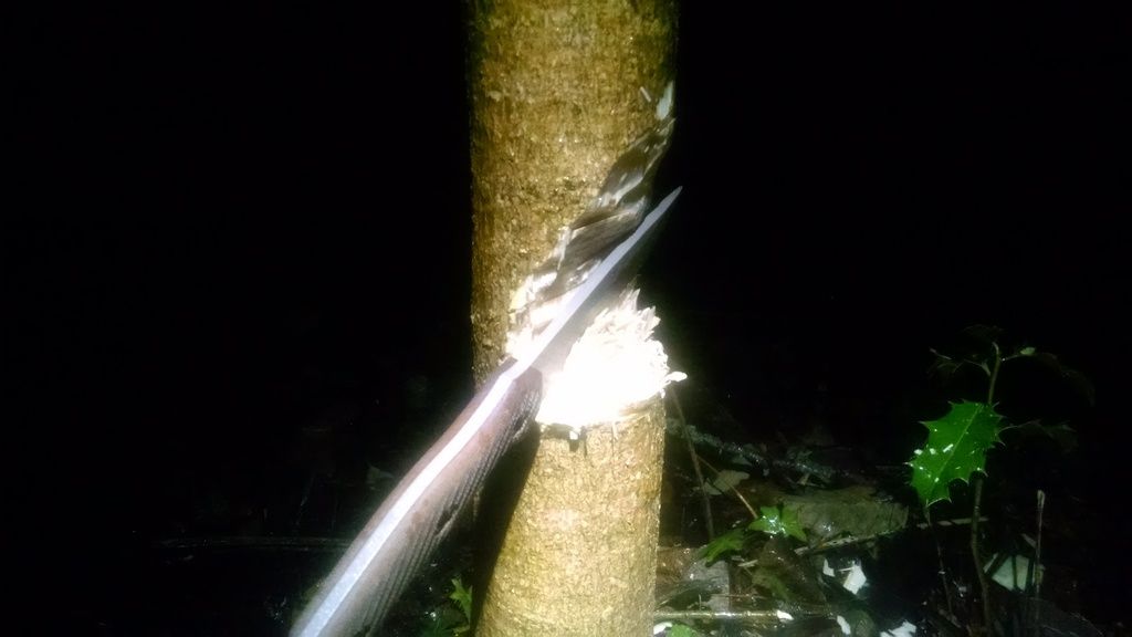

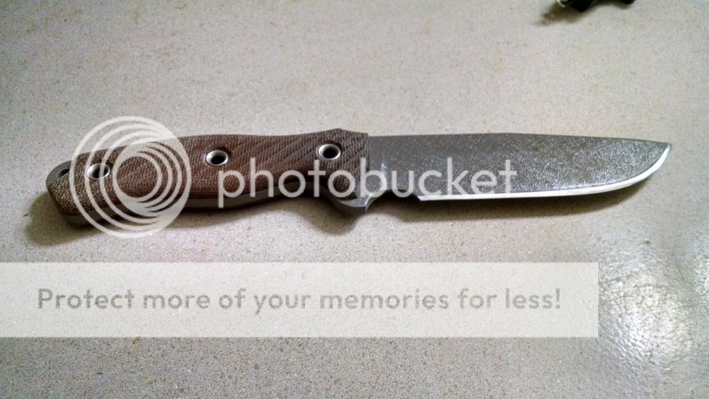

It's a rainy and cold night. 40°f with a steady down pour of rain.
Time to play in the woods for a brief moment.

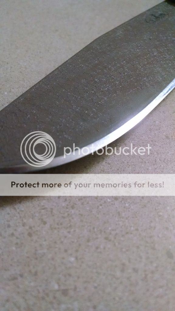

When I got back from my little excursion my Ratmandu was completly soaked. Just like me.
No rust to be found. Even without oil. It seems a highly polished edge on carbon steel inst just for looks. I'm impressed.
I guess its time to reevaluate my opinions.
Thanks brother, I was jones'n bad for some action.Sounds good and Thanks again, you certainly are a hardcore knife beater.Nice pics too especially at night and in the rain and cold and still out testing.
Have a good one and stay safe out there.:thumbup:
Very cool. Yes, one thing old school knife makers know that is all but a lost bit of knowledge these days, is that a mirror polish on blades does help them resist corrosion. Rough finished blades will rust a good bit quicker than ones with a mirror polish.
