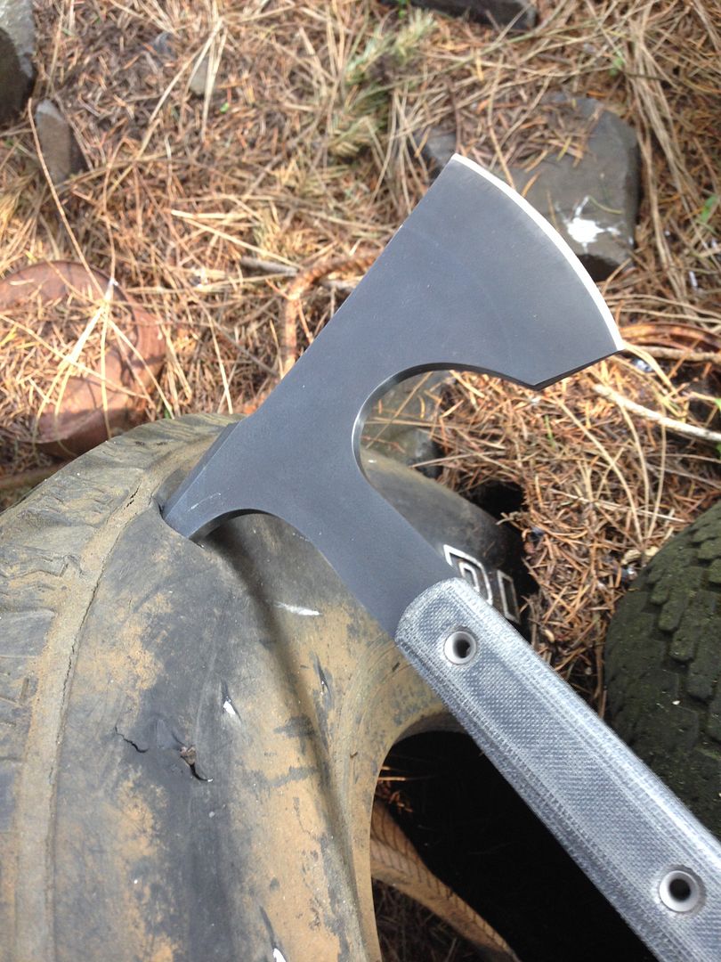

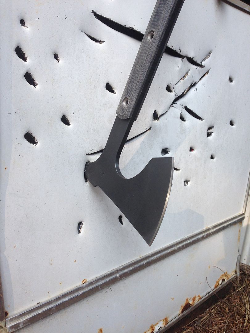

Mine is more of a tool than a purpose built fighting hawk. Some of the design features on mine that make it more tool like. Are the full length handle so you can choke up on the axe for any task. A spike designed to fit in a master lock for breaking them, its strong enough to be used for digging and punching holes in metal, but pointy enough to still puncture tires. (See video's below)
