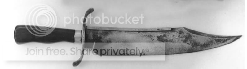

I think I know how to do this. Is it not just channeled into the blade and slid on during assembly? Before I mar a good blade, can anyone(who has done one) shoot me some pointers?

Silver braze, or brass braze it on. Use a 1/2"X1/4" brass bar, and set the blade down the center, leaving the excess brass sticking out both sides. hard solder or braze the strip solidly, making sure all the seams are flowed and there is a bit of excess braze material making a slight ogee. Do this before HT. Don't clean up the spine before HT any more than to remove the bulk of excess brass. At HT time, clay coat the spine well. Use a torch or forge on the edge and edge quench the blade. Just let it sit upright in the quench pan for ten minutes to assure the brazing re-crystallizes properly. Then you can grind the spine/blade smooth when you do the final sanding on the blade.
The alternate method requires making an exact machining of a "U" channel in the brass and matching shoulder down the spine. Once tightly fitted, the assembly can be soft soldered on. This can be done post HT.

I made one for my Musso Bowie. The original was soft soldered brass channel. I used 1/32" brass carefully hammered over the spine, removed and cleaned up. Since this was made as a collector piece, I just used J&B Weld.
The original
