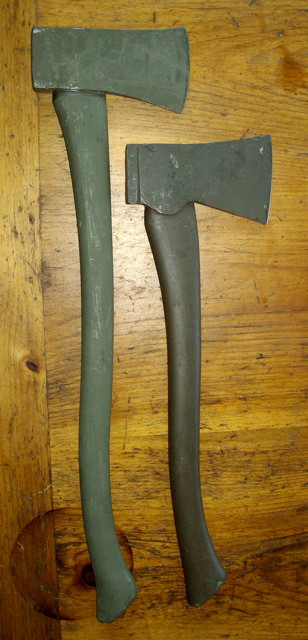

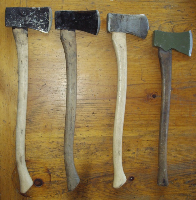

Peter Vido got 20 (!) and is satisfied with them, all things considered.
One of his 20 was undersized and looks pretty nice:
Here are more examples of the variety found in Peter's batch:
