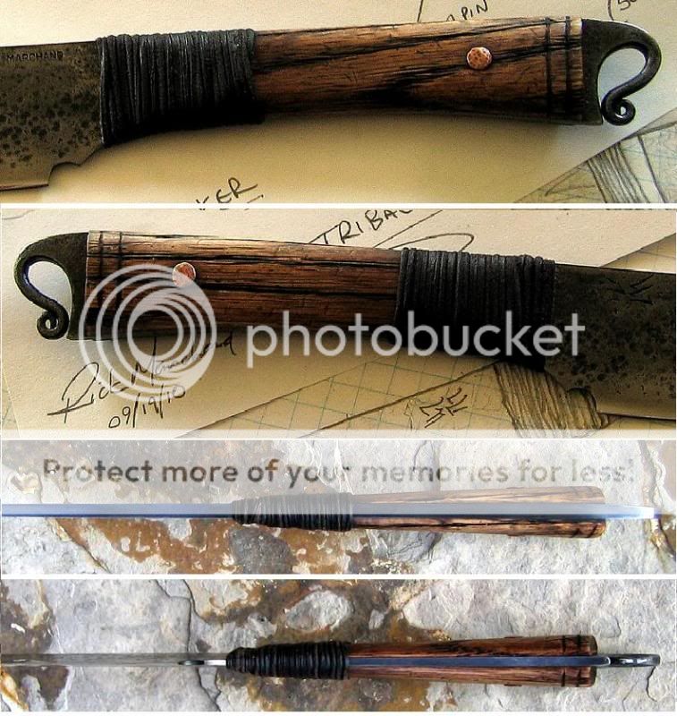

Hey folks,
My humble take on an tribal/skinner type blade... "18th Century Tactical"... Ha!
Swept Tribal Necker
5160 Mat'l
10 1/2" overall
5 1/2" blade
5" handle (4 1/4" scale/wrap length)
5/32" spine at thickest
Handle is distressed oak, rawhide wrap (epoxy sealed), copper pins, carved accent bands, finished with danish oil.
The neck sheath is 10oz cowhide covered in Goatskin...
The knife was entirely made using handtools only. There are no plungelines... the bevels run the length of the blade and into the tang so the tang itself is wedge shaped. I like finding different grain patterns for each side of the handle... symmetry in shape but variety in pattern makes it interesting, IMO.
The price is $595 shipped anywhere in North America. (Int'l M/O or Paypal accepted)
Close-up of pin and scrolling.
