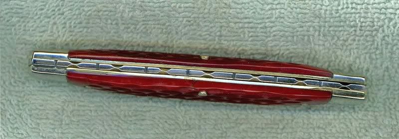

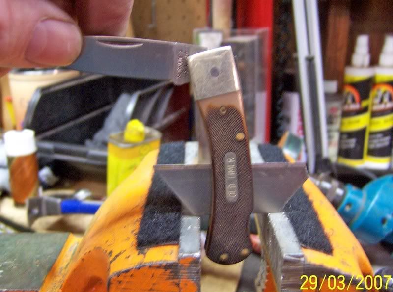

Recently I decided to put red jigged bone handles on what was left of a 770T I picked up some where. The blade with tang stamp was broken off at the tang. I thought some of you might like to see a Swinden key if you had not seen one.
Here are the pieces of the knife. Notice the keyway cut into the end of each liner.
In this pic you can see the Swinden rivet that goes into the keyway.

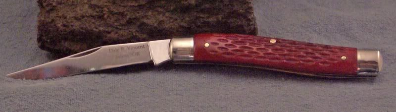

I had one little problem when putting it together. When I inserted the rocker pin I got a hairline crack in the mark side. It happened when I put the pin in, not when I peened it.
Other than that, it came out OK.
