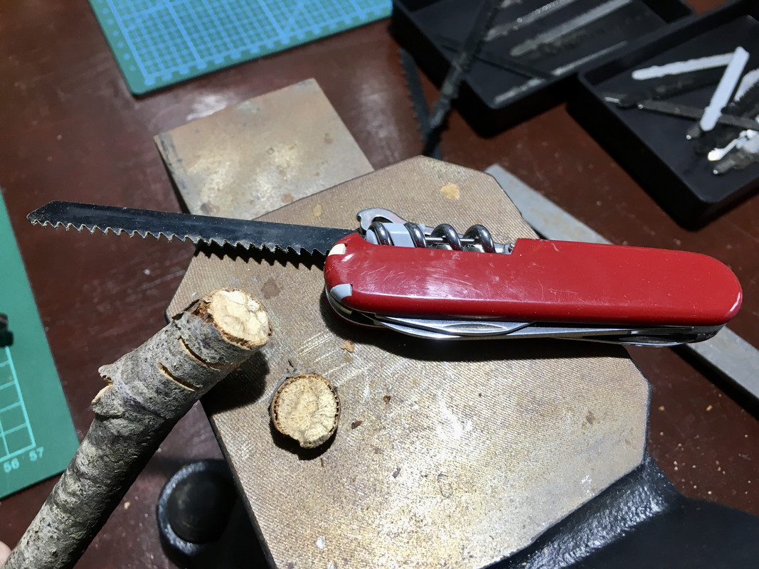

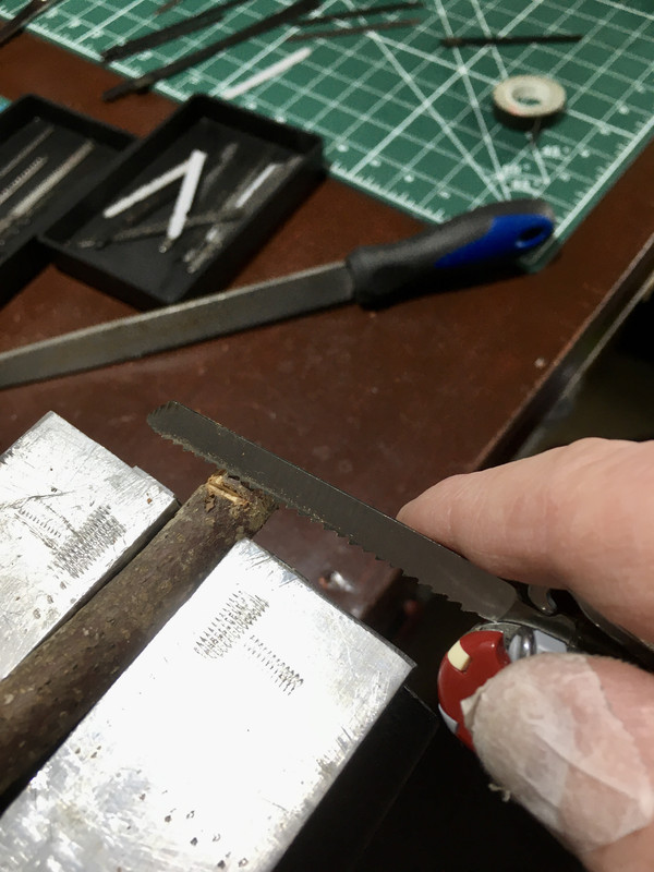

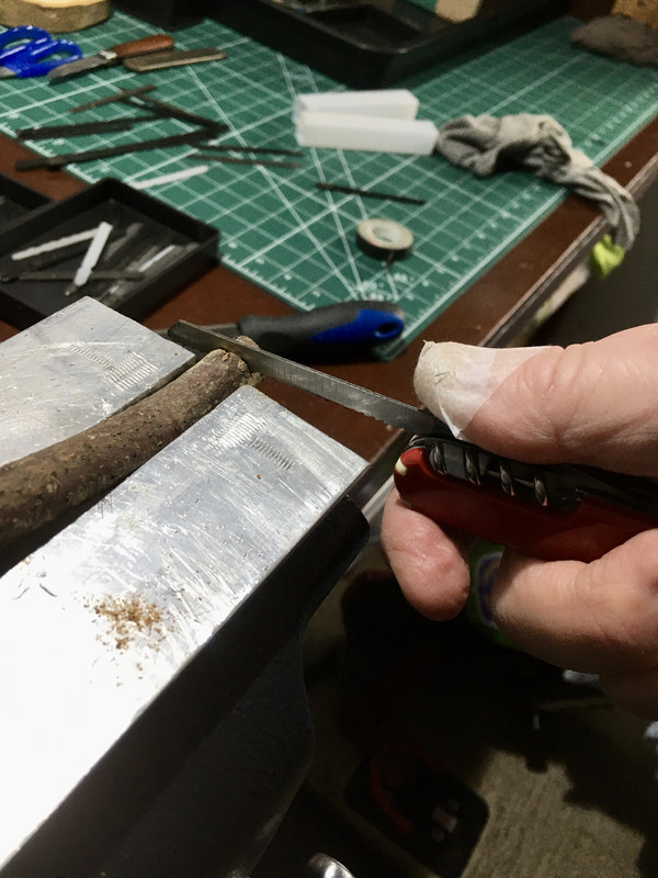

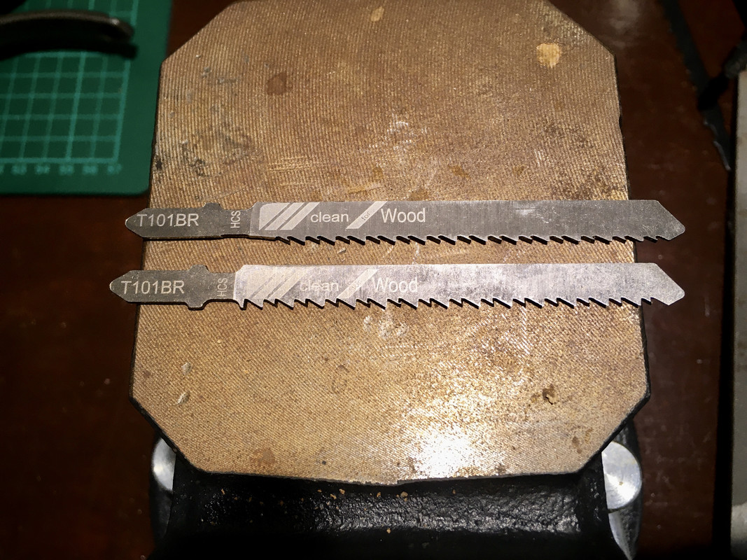

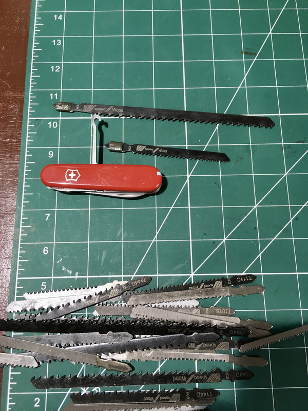

If you line up your 3 magnets along only one side, it works as another method of stabilizing the jigsaw blade. I don't know why I didn't think about trying that before.
Here are the 3 magnets nicely tucked in with the jigsaw blade. There is a sweet spot of jigsaw thickness where this works well. If your blade is too thin for this, then maybe you should try putting the magnets on both sides of the blade instead of just one side.

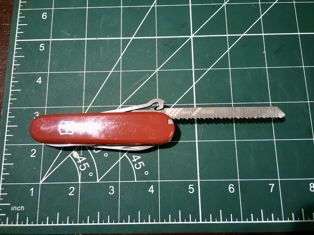

This also works on the Lenox General Wood blades. You can see these blades are almost the same length as the Bosch Progressor Wood blade. I think the Bosch used to say "234X" on the shank, but it's been partially scratched off.
They're also pretty much the same thickness. The Lenox jigsaw blade is on the top and the Bosch is the one on the bottom. They are both good choices. They both work well. There is no reason for the magnets to be in this photo except that they made it easier for me to hold the jigsaw blades while taking the picture.

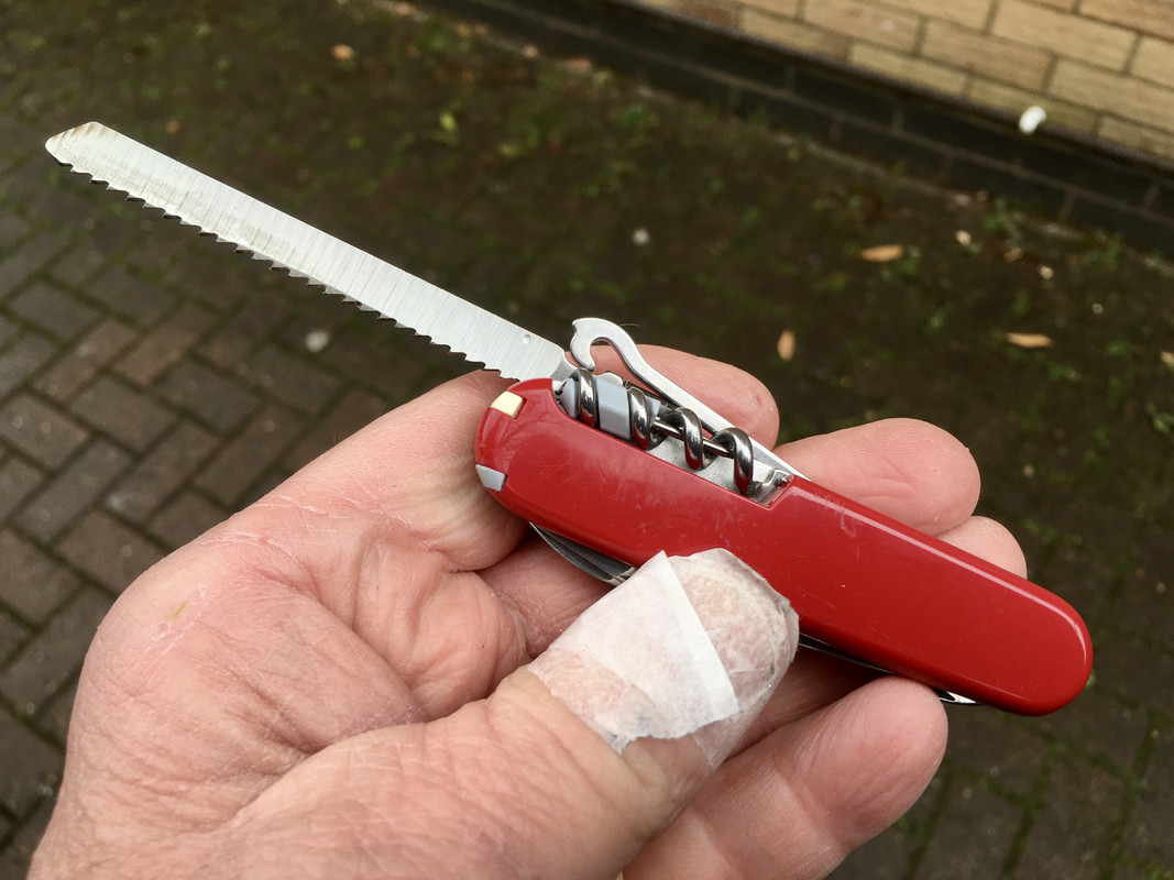

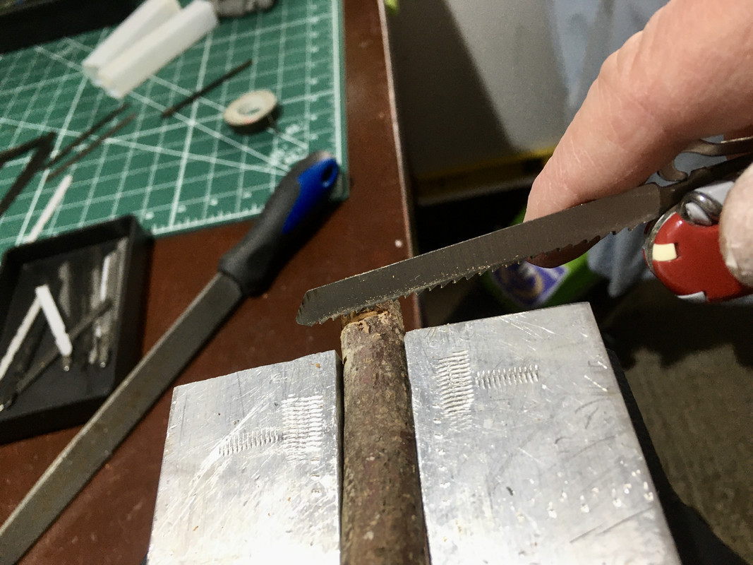

If you look at this parcel hook, you can see that there is something nested inside of it. It's a stack of 3 circular neodymium magnets. Their dimensions are 3x1mm each. Together they match perfectly with the inside dimensions of the hook, and you can close the hook down to store all three magnets in your SAK. The idea for this came from Felix Immler's channel. He did a video on storing magnets in your SAK, and he demonstrated some different things that you can use them for. One of their uses was to make a navigational compass needle with the Victorinox straight pin.
T-shank blades are metallic and ferrous (they have iron), which means that magnets will stick to them.
Theoretically you could use these magnets to help stabilize a thin saw blade, but I don't have any blades thin enough to try this with.
