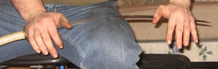

sword bent when hitting tree branch
yeah im not kidding....
i made a handle too obviously...will take pics, i just used two x 4 wood and used an aluminum rod for the pins.
basically this was just practice to get used to grinding, making the handle AND GUARD ETC.
thinking about it now, it wasnt smart hitting the tree but i wanted to see how sharp it was and how well it cut.
seeing as how it was low carbon i didnt fear it snapping.

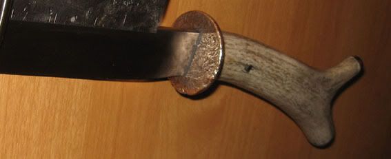

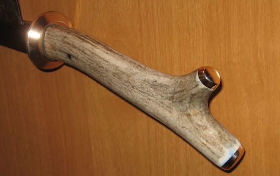

I would say thats just awesome for your first. I basicaly just got into knifemaking(as a hobby) this fall, and am realy interested in short swords. Basicaly propane forge, wood heated quench tank and a 1x42" grinder is the only tools I bought/made for this. I am still pounding scrap leaf springs into blades, and have recently started casting my own gaurds from scrap brass. Actually most of my blades cost next to nothing to make, as its mostly found/recycled materials... Other than propane. It took me a few times to get something acceptable made. My main goal was to cleave flesh and bone without damage to the edge(chipping, or rolling). believe it or not I found that deer bone is as hard or harder on the edge than trying to cut steel oil drums. But I did reach my goal, and learned a few things in the process.
Once I get my power hammer built, I am going to try and weld some 1080 into a U of spring steel, and see how that works. The spring steel I have (likely just 1060) isn't that great at edge holding at ultra low angles compared to some 1080 that I have played with.

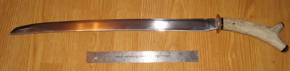

This is my 4th and latest atempt at a 'sword' I know I know.... its all backassward... just an experiment. And No it wasn't sharp when I was doing the flex test.

John, look to your heat treating. work with known alloy steel, and heat treat accordingly, you will be amazed at what your common spring steel can do. My undestanding is that the number one choice for steel for ABS journeyman tests is 5160.

build them to cut wood and you can do it all you want...though your heat treatment really ought to be priority
Never mind the "don't hack at trees" snobs, i've been making swords of many geometries and hacking at everything for many years... just build them for the task
Geez. Thats kinda harsh. Seems those snobs are just concerned.
The sword was obviously not built for chopping wood. Sure, if you build a khukuri, then chop away.
Adam, After seeing the pic of your sword I think it looked great for a first try at anything. It takes a certain amount of skill and patience to do what you did, but please friend, take some time to do some reading. Your work will be a thousand times better for it.
Looking foward to seeing something you make from a good steel.:thumbup:
