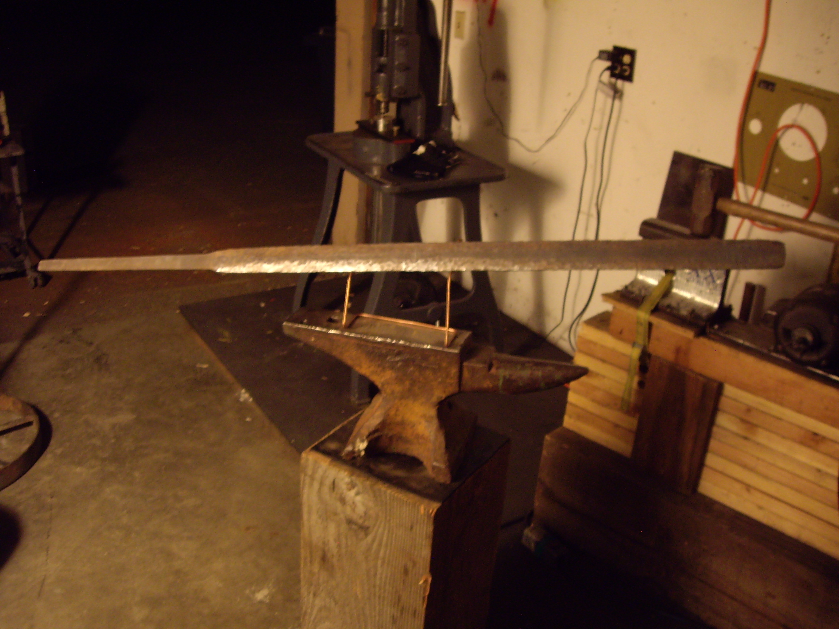

Apologies for the crappy photo. Here is the billet after a few good runs of fly press work and hand-forging. Some shaping of the tang and refinement of the blade, and this sword is heading to grinder city for rough shaping! It's about 5 feet long and exhibits a healthy distal taper.
HOLY... awesome! and not just because the landsknechte are a known tradition in my hometown... this looks really promising!
Thanks evltcat, and everyone else! vilePossum, I'll do my best to make this sword exceed the needs of the finest of Landsknecht.
