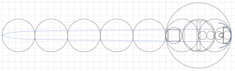

A.McPherson A.McPherson I built the geometric construction described in the video. If you make the 7 primary circles 5" in diameter, then for a guard of 0.5" thickness, the space for your hand is almost exactly 3.5", and the sword would have a total length of 35".
Scaling up to snugly accomodate my hand brings the total length to 40", providing 4" for my hand.
