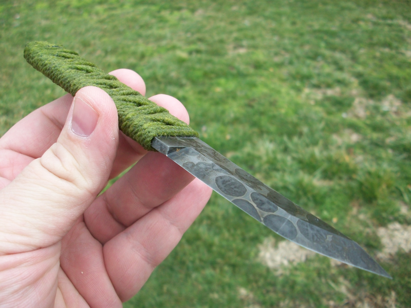

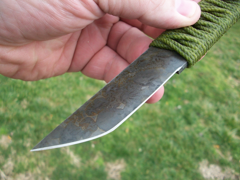

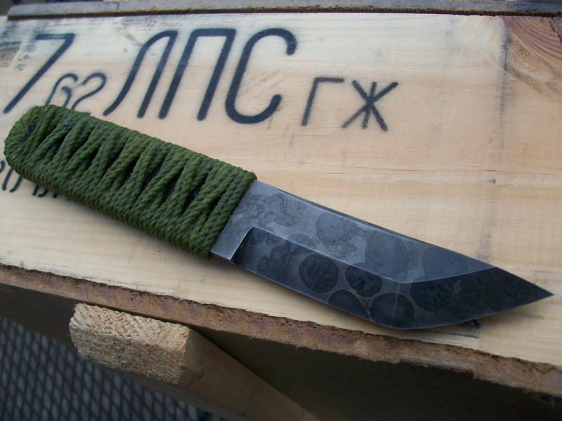

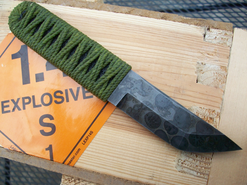

This one's a little different from me. Went with a zombie theme. The blade is a mustard/vinegar patina that was made to resemble decay. A BF member also said the patina looked like infected and mutating cells, which is also very cool.
Specs:
Aldo's 1095 - 1/8 - 1in wide
OAL -7 1/4in - blade length 3 1/2in
Peter's heat treating - 60rc
Green dyed round cord - Naka-Biku Maki wrap. - West System epoxy soaked.
Very fine Scotchbrite finish
Zombie mustard/vinegar patina
Assymetrical chisel grind - Razor sharp.
Kydex sheath -large tek lock compatible (in progress)
