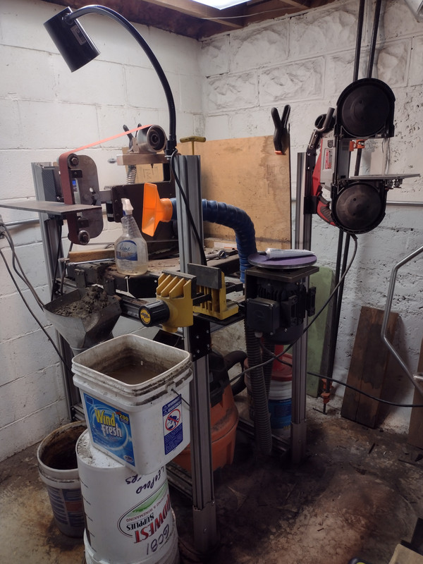

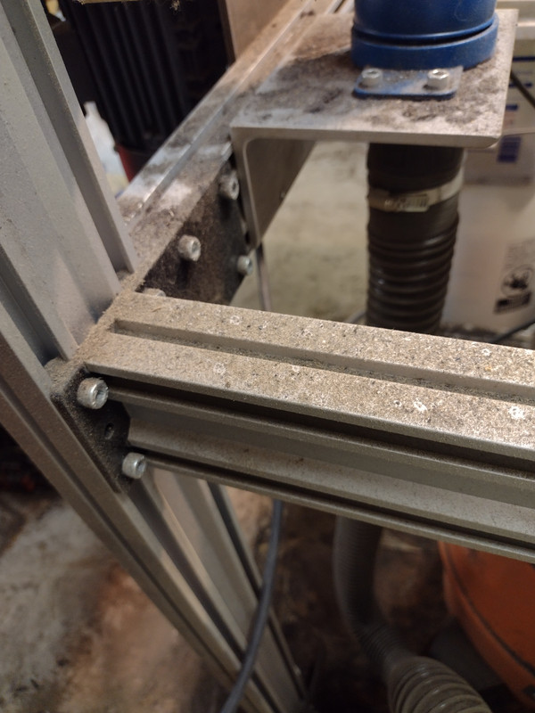

I've shown my table in various stages here a few times, I think it's perfect, but I built it myself out of adjustable aluminum extensions.
I've adjusted the heights a couple of times already. I'll try to record the various working surfaces relative to my height once I go back down there.....

It would just be easier if I took a few pictures.....give me a few minutes

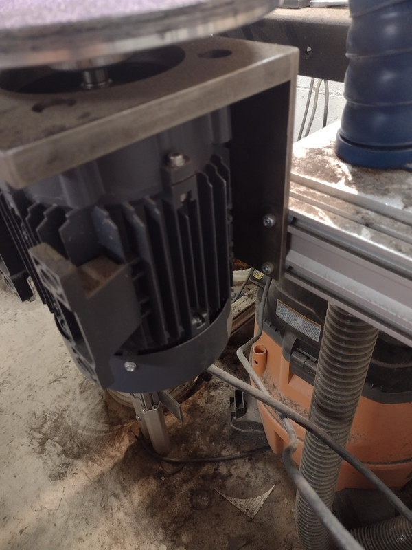

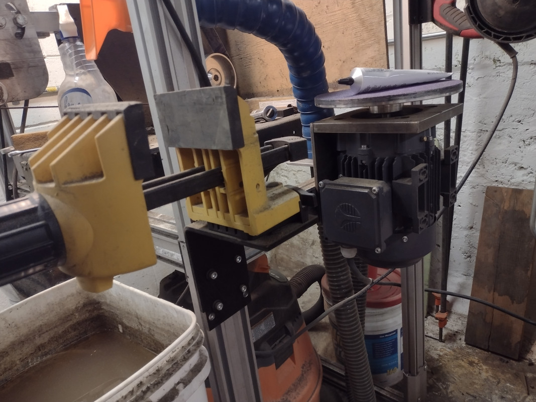

Top of work surfaces. I'm 6'2" tall
Grinder table:49"
Grinder top belt area for reverse convex: 57"
Vice height : 43"
Disk grinder height: 41.5"
Bandsaw table height: 51"
Drill press table height: 41"

Craig, that's as nice and compact worktable I've ever seen. GREAT job - lots of tools in a very small space. That portaband is just right. Congrats on all of it.
this is the bench I built for my grinder to sit on. I installed a 1/2" riser under my grinder a couple days ago and it's already making a difference wrt neck strain etc. Might add a little more height

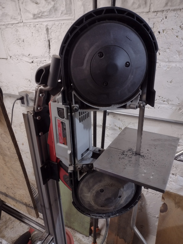

Thanks.... I even have two more sides I could attach stuff to. Haha
Although it's against one wall, because my shop is so small.
I do plan on bolting on a blade sanding attachment support on the backside. Some day.

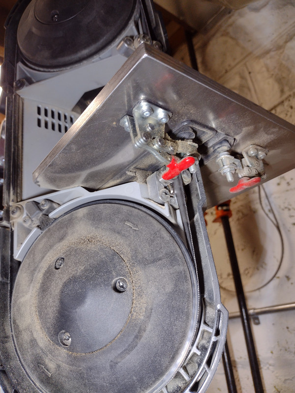

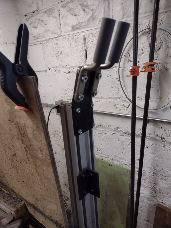

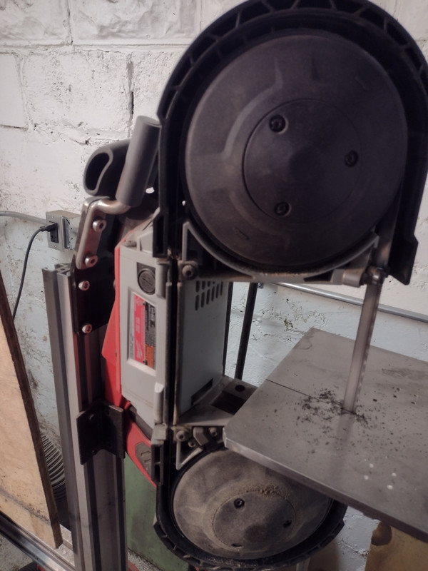

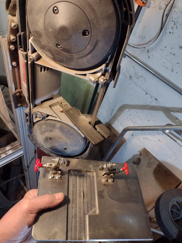

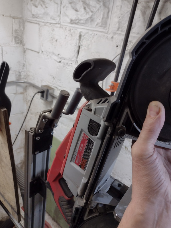

Lift saw up, and off mounting hooks.

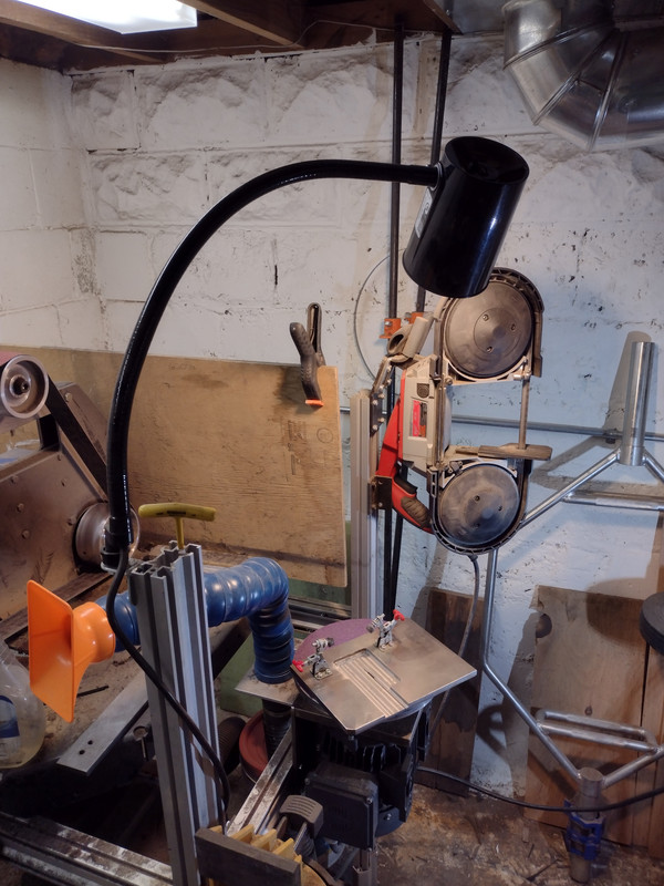

Bandsaw table mounted on stock saw with toggle clamps.
My favorite is my Moffat light mounted.
