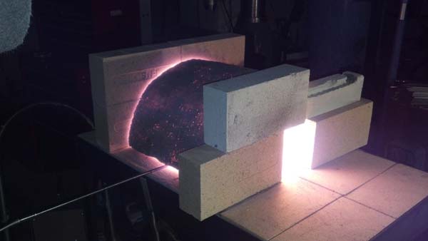

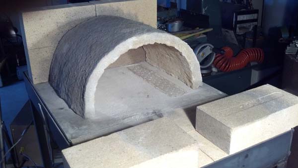

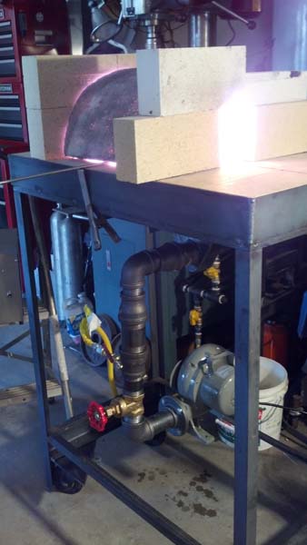

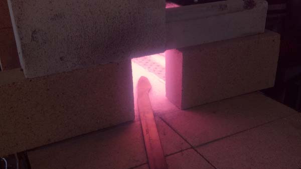

I've had a project to build a table forge for some time. All the parts have been lying around but never got in the grove to make it until I was motivated by seeing a ribbon burner at Travis Wuertz hammer-in last month. Well this forge has far exceeded my expectations. I'm running it with 1/4 PSI residentual natural gas and getting a temp range from 1600F on the low end to 2300F on the upper end. Running propane takes no special effort either. Just disconnnect natural gas line and hook up propane bottle. No changing orifices. This burner is so versatile. It's nice to be able to lay a piece of bar stock inside rather than balance a short piece in my vertical forge. Super even heat with no hot spots in the forge. Unlimited door configurations with bricks. Shell is a 12" X 22" X 2" piece of high temp wool with a light refactory coating (satinite) as a rigidizer. Here are a few pictures. The link below shows the build pictures. Man I like this thing...

I've had an unfinished ribbon burner hanging around in my old shop for like six years now, never got the castable to finish it. I've wanted to build one since seeing pics of a build (crayons) in the NWBA's Hot Iron News. I never thought to put one in the floor, did you come up with that? It must work well, otherwise you wouldn't be so happy with it. This must be a pretty quiet forge too, I've seen one run before and it was just kind of whispering along. How long do you think that shell is going to hold shape with the satanite? I like the look and simplicity of it, I'd probably have used a steel half shell over it but your way may be better?

Hey Salem. Glad I can help your never ending money pit quest for more tools... :rolleyes: This project was one of those things just sitting around my shop for a number of years too until I was inspired by seeing a ribbon burner in action then watched the candle trick as one was made for a person at the hammer-in. My design for a floor burner came from seeing a single burner forge like that at Mike Vagnino's shop about 4 years ago. He had the same type of shell but much smaller and it was a little portable kit unit, chamber maybe 5" X 9". He had ordered it from someone in the pacific north west as I recall. The kit came with a blower, steel frame to pour in the refactory, a burner and the shell material with rigidizing instructions. From what I understand his rigidized shell is still going strong. It's so light unless you crush it I really do not think it will lose shape. Yes, the forge is very quiet. Just the sound of the fan rather than the roar of a traditional burner. As far as the candles go, I just took my heat gun and stuck it in the 3" pipe opening at the bottom of the burner and those candles were melted out in no time. No drilling required. It was actually a pretty easy build compared to other forges I've made in the past. BTW, I made mine out of an old welding table, scrap steel for the burner, a few fire bricks and bag of castable refractory from the local pottery store, pipe and valve from another old system and a second hand blower. All in I'm just around that $150 mark for the build. Not to bad.

Mike, No I did not cast in a thermocouple but that would have been a good idea. I just slipped it under the shell. You can see it coming out the side in one of the pictures.
Dsgibbs1, yes it is large for just knives. I actually plan on two shell sizes, a smaller one for just knives but this size was need for a project that I could not do with my small door on the horizontal forge. Spurs... There are may blacksmith projects that in the past I had to go use someone's coal forge due to the size of the parts. With this set up I should be able to do most of my blacksmith projects right at home.

Hello Deker. My original plans were to have the burner stand proud by about 1/4" to keep flux away from the burner holes. I've been fluxless for about 6 months now with my Damascus and do not plan on going back. If you are going to be building a flux wall, I would think a 1/4" would be all you need. Maybe even 1/8". Just enough to keep flux from settling around the wool sealing the burner next to the refactory. As far as stabilizing, it does take longer than a pure kaowool forge. I'd say it took about 20 minutes until it was stabilized for welding heat. That was with my large dome top. Looking forward to trying a smaller chamber size as well. Just need to cut some more wool, paint on some satinite and set on a cylinder the size I want the chamber to be and let dry. Mods are so easy with this setup... Let me know what you go with.
