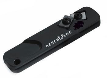

Ok...ok...I know this isn't the thing most people care to hear especially those of us in the knifemaking world but, I found the greatest little pocket sharpener (carbide) I've ever seen...it's made by Benchmade (and others I suppose). Anyways, if you're out someplace and need to put back on a decent edge quickly, this is a dandy and it's easy to stow in your pocket too. It runsa about $15.
Maybe I should have clarified my use of this...I don't use this on my EDC or other quality knives, I have used it often in a pinch on my large camp knives. I have two pretty hefty thick 1095 steel choppers that get used hard for every grunt cut job and it works great to get a half ass edge back on them.

Sharpmaker sharpens the same way, but one per side.
It's just the carbide, and the fact that your push down on the edge that leaves such a horrible looking edge.
Think of those micro-edge pieces breaking off when you cut food :eek:
Tried such sharpeners once...never again. Edge rippers I call them :rolleyes:
If you must use a pull through sharpener get a Rapala two stage sharpener. Instead of carbide blades it has coarse and fine ceramic rods that won't destroy your blade. Around $3 bucks.
A fallkniven dc3 or dc4 will cost about $5-$10 more and you can get a great edge with those. Comes will a leather sheath too.

The problem with these isn't what the edge looks like under a microscope, it's the damage that it does as well as the results. Consistent use will typically result in a torrn up 'wavy' pattern to the edge, (for lack of a better word). As the knife moves into thicker metal, it gets worse. It's also an indication that the user doesn't properly use the knife, and will basically saw thru everything, because the knife will no longer push cut, or even slice well. It also shortens the life of the knife, which may not matter on a cheap set, but will on a quality set. Have your mom's knives properly sharpened, and I'll bet her attitude would change. "Cutting better" and cutting properly, are two different things. It's not working properly... her expectations are just lower. I see it all the time (which is also why users will cut themselves with a properly sharpened knife... they're not used to how it performs).
