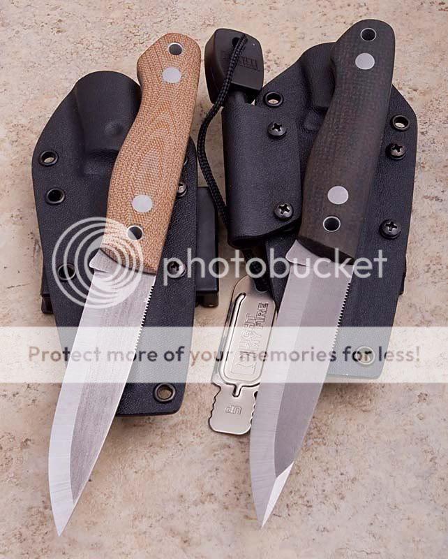

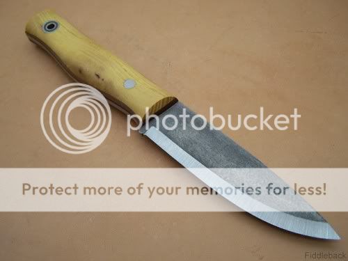

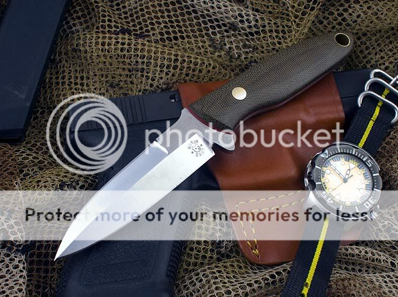

the blade of this knife
with the handle of this knife...
and to top it off a Kydex sheath on the right with the fire steel
if any one has photo shop and can some how fuse it all together it would be much appriciateted, and thats about my dream knife....

This knife would be an absolute PITA to use in a bushcraft situation, and is the perfect example of why I said above that tactical features impede bushcraft use. Notching is not easy because the edge is inches away from your fist. The serrations are useless in Bushcraft, and a total waste of the most important part of the edge. The finger notches in the handle prevent anything but a defensive grip. Upcutting would be uncomfortable. Not good in the kitchen, not good at skinning.
If stranded and some guy pulls this thing out, and ties it to the end of a stick I wouldn't be suprised. I'd expect him to pound his cest, "weapon, grunt, grunt." I'd slip away to the other side of the island before I have to spend my energy trying to save his life.
If you're parachuting into enemy lands, this one would be better suited. But for a woodland tool, I'd rather just have soap.
