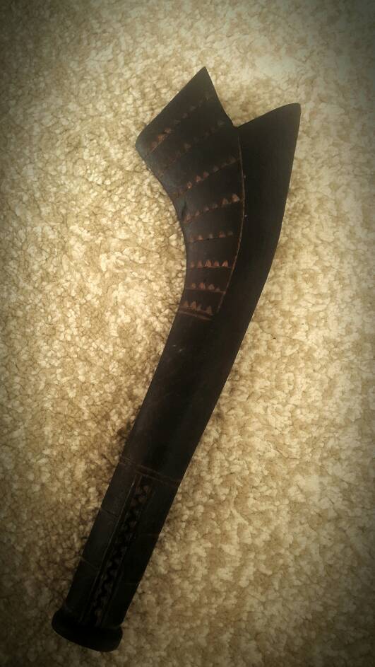

It's for combat. I'm not an expert but I believe there are specific uses regarding the beard which involve "hooking" type moves in some martial arts using a tomahawk. So the design is theoretically meant for traditional use as a weapon, while the spike is added to the design to increase penetration. If there were no hooking being done, I'd think that the design you posted recently would be better for doing damage, although it's also worth noting that a longer cutting edge increases the chances of making contact. I agree with Moonw about that sharp transition, I can't think of a reason why that wouldn't be curved between the main cutting edge and the spike.

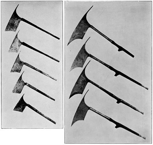

These 'hawks were developed with Filipino Martial Arts in mind. The design is an adaptation of Igorot headhunter axes.
Heh, that is exactly what I thought.
But on the other hand - headhunting axes had one continuous edge.

Those ingorot headhunters were very thin when compared to european axes. But, on the other hand - no armour whatsoever.
I will need to think about making and comparing both solutions - continous and combo edge.
