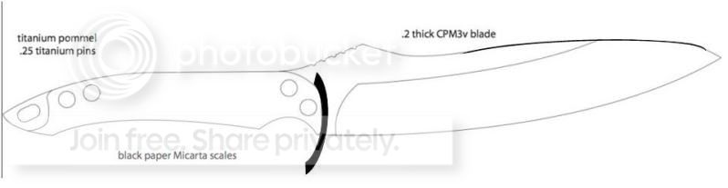

I read this earlier but I was at work so I couldnt post a pic. I like the shape of the handle but I do agree with some of the other comments. As for the word tactical... I won't get into that. I made a couple of changes to your design. Just a quick edit but Im sure you get the idea.
I'm a fan of different; I am not worried about the meaning of tactical. My only recommendation would be shrinking the blade or increasing the handle size (balance the proportions).
Then make what you like. :D
I draw my blades with Illustrator to get a first draft just like you. One thing I find helpful is to make a mockup to see how it feels in hand and if the blade angle is comfortable/usefull. Some folks use 1/4" plywood. I use foamcore and just spray mount a print and cut with an x-acto knife. When you have it in hand, it will be pretty obvious if the ergonomics are wrong.
Practice using the knife. The handles on a good working knife need to have both pulling and pushing resistance. Pretend you are pushing it into something firm to see if your guard is substantial enough to keep your fingers off the blade. Also do some pull tests to see if you have enough resistance to keep the knife from slipping out. Also try it bare handed and with gloves to see the difference in feel.
You can do multiple tweaks until you get just what you like and then you have a good pattern to stick on your steel. Final ergonomics can be tweaked when you get handles on.
Works for me!!
I will give my input..I actually like the design, but think it would be better served in the kitchen as a nice slicing knife ( not at .2 thick though ).

The OP's design looks like a pretty good slasher with that upswept edge... but as some have already said, it is not aligned right for thrusting and lacks a guard for grip security.

Bigger Handle
Shorter Blade
Non Nesmuk blade
No Pointy handle parts
Just off top of my head things id change.
